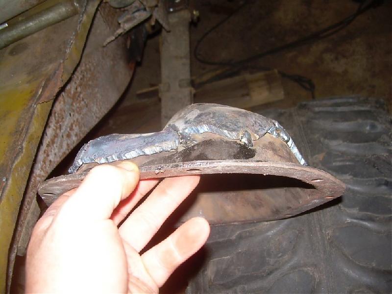

rear axle is now centered and under the truck for good. I built a bad dood front dana 44 cover out of the stock dodge cover and a ford ttb diff, thanks for the diff karl. I also drilled both knuckle's out to accept the 3/4 heims on my steering, totally cleaned all sand/mud crap out of the axle tubes and housing. The only things left to do on the front is put some more weld on the spider gears, and re-install all of the shafts and such. I also started the boat siding.
Here as some pics of frame repair, rear end with patented frick- axle jackstands that allow you roll axles around the shop floor with extreme ease, and diff cover. Also my custom carb tuner at work.

Texas chainsaw massacre facemask diff guard!
Why didn't you just cut out the entire bolt pattern/cover from the ttb and use that?:confused2
http://tamor.org/forums/attachment.p...1&d=1236360059
the covers dont have quite the same dimensions,as you can see from all of the cuts in the ttb cover that i scabbed on top. That was the original plan when i made the cover. It may not look great but it makes for a cheap an really thick front cover.
The bolt pattern is not the same?
