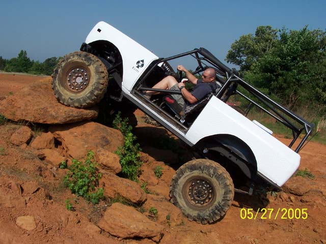

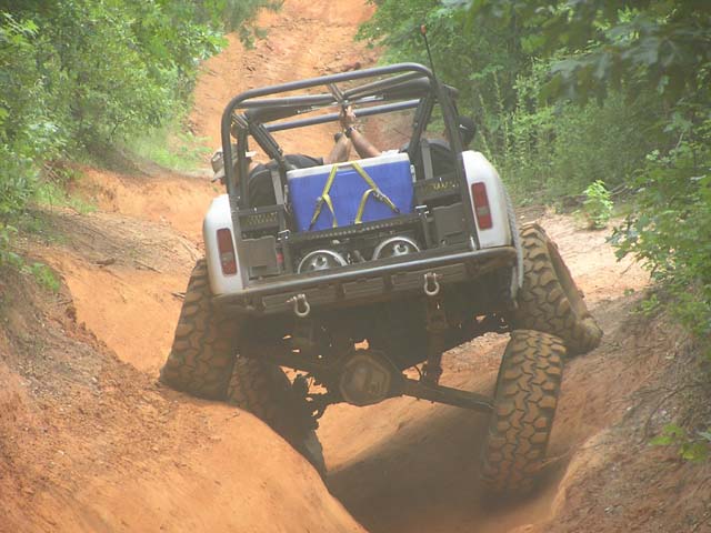

Finally got a chance to post a few pics from the Scout's Memorial Day shakedown run.
Poseur pic:
http://tamor.org/forums/attachment.p...tid=6008&stc=1
Sunday Cruise:
http://tamor.org/forums/attachment.p...tid=6005&stc=1

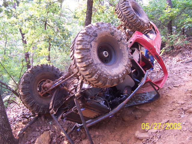

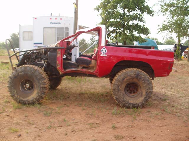

Highlight (lowlight?) of the weekend. My buddy Josh Kurtz's K5. D60/14 bolt, 44" Boggers, Vortech 350...and a ruptured brake line do not make for a good time. Fortunately no one was hurt:

he shoulda gone a little farther with that tube!
Holy inboarded springs! Did your rig work well?
Yeah, I was very pleased for the first time out. Only issues were with the front wheels, a leaky fitting on my hyrdo reservoir, and my trans temp guage pics up heat from my exhaust...either that, or my trans gets REAL hot, REAL fast for no reason at all.
Turns out lug centric wheels and hub centric hubs don't mix. Who'da thunk it? :D
EDIT: Best part about the K5 was he hammered the roof up and drove it half the weekend like that. :laughing: He's thinking S-10 cab, exocage, and back half it.
