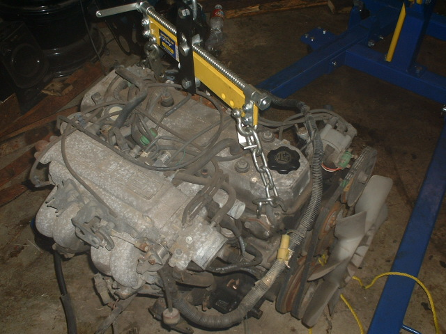

well after 2 days of running around trying to prove to everyone that i had a bad injector and that in fact toyota injectors DO go bad, i just went and bought one at autozone for $50, im also getting one for free in the mail.
also plugged in erics gauge cluster and pulled the codes for it... got them all taken care of so the motor should run perfect after the injector is in.
but while motor was apart i painted the intake and cover and painted the engine compartment.
