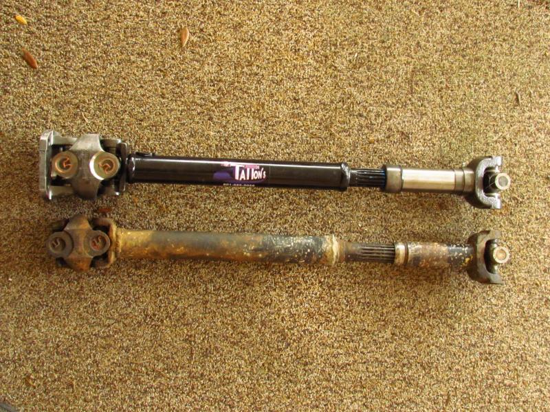

If anyone is looking for a driveshaft builder this guy is great. I would highly recommend.
New 1350 hotness next to old Tomwoods 1310.
I custom ordered the 2"x.120 tubing and the total was still $250 cheaper then the nearest quote.
