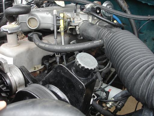

I am a little confused. What exactly is a saginaw pump. I thought that is what I have. It is the black , pear shaped pump from 87+ ford truck v8s? For hydro assist, I should just need the cylinder, hoses, tabs, an additional resevoir, and to drill and tap my box. Correct?
the saginaw pump came from ford van v8s. or even the 300 for that matter. you have a serp. set up on your 302 so you'll want the power steering pump from lets just say a 1995 van with a 302. you'll also need the ac and power steering pump bracket from that year van. go check out Gordons, the last time i was out there i was 4 or 5 Ford v8 vans with the pumps and brackets still in them.
http://www.supermotors.net/getfile/5...e/dsc01150.jpg
If your pump looks like the one in William_ace's photo it is a saginaw. On my 1990 302 I did not have a saginaw. I swapped to a saginaw. I just removed my old pulley and put it on the new pump. Bolted right up. Had to get a different hose.
The saginaw is not required for hydro-assist, but it is generally a more beefy higher flowing pump. If your old pump goes out, I would make sure to have a saginaw.
Oddly enough, my thread on this has a linke to a post by you on the part number, so yes, I would say you have a saginaw pump. So yes, get a cylinder, tap your steering box, hook up hoses and add some sort of reservoir. If it does not turn, swap the hoses.
I have a saginaw pump.
But I still would want an external resevoir correct?
yes you would i believe PSC sells just the can
