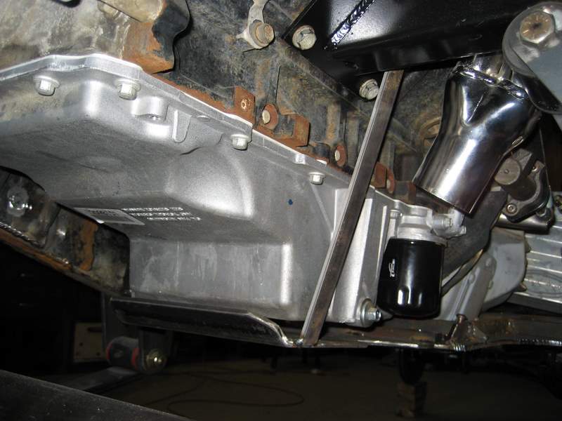

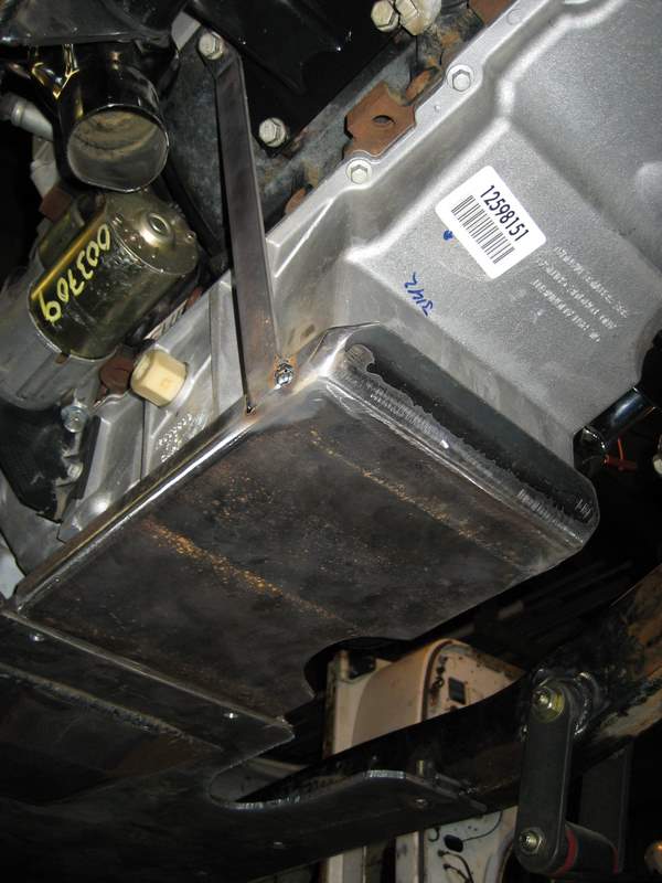

you should have powdercoated this thing pink too, because its gonna fold up like a pair of panties the first time it sits down on a rock. :flipoff2:

needs more triangulation....
I would really listen to John on this one, he knows about how limp some things can get...

look how close that skid is to the front axle. It's barely possible to even hit the pan on a rock. The front axle would have to clear it first and it's never going to hit.
Part II - the only way that the oil pan will crack will be from a "point" syle impact (a sharp point going into the middle of it). Even if for some reason, a rock was able to get past the frame, leaf springs, driveshaft, and front axle to bend the skid plate up - it will hit the oil pan as a flat surface and distribute the load across the entire oil pan. The majority of the energy from the hit will be absorbed in the bending of the skid support arms resulting in a minimal amount of force hitting the oil pan.
I have been wheeling pretty hard for over ten years and have only brushed my oil pan a few times. Take a look under anybody's rig that has 10 plus years of hard wheeling and check out the damage to the oil pan - it will be minimal - it's just really hard to hit - you never line up rocks down the center of your rig because you'll just hit it on your rear diff.
Like every decesion made in life, it's based on risk. This risk is minimal, and the protection on that risk is adaquate.
On a side note - I have seen one crack on Greg's low slung buggy, it just oozed oil in a slow drip, nothing to stop you on the trail.
decent arguement. i just couldnt resist. :)
