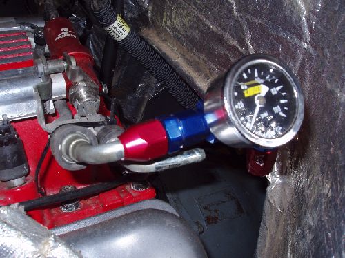

I wanted to put one of those in between the tank and pump so that if/when I have to change it next time I don't have to take a bath in gasoline like I did in Rusty's parking lot. The other I was going to put on the return line so that the tank could be pulled w/ fuel in it if needed.
I had to order more fittings than I was planning as the -8AN hose to 1/2"NPT fitting was on back order. I ended up ordering -8AN hose to -8AN female and an -8AN male to 1/2"NPT to make it work. Some quick disconnects would be peemp, just have to do some more looking around.
