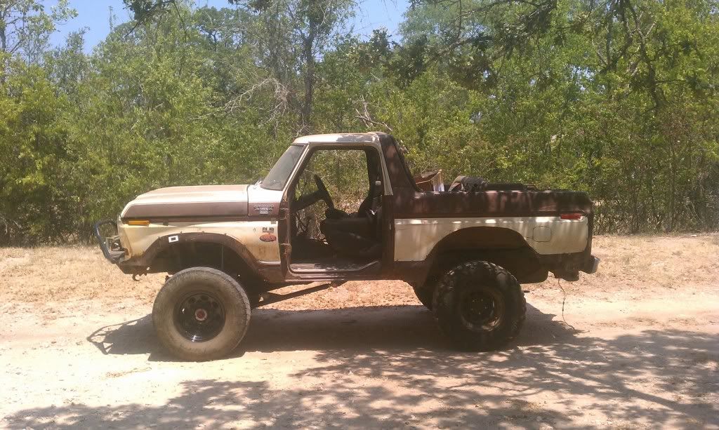

Damn people that steering is fine. It's a 79 Bronco, not a Ferrari.:laughing:
Did a couple of full lock turns around Travis' property earlier. No rubbing and the turning circle is about the same.

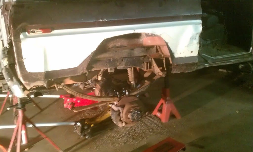

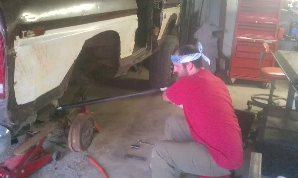

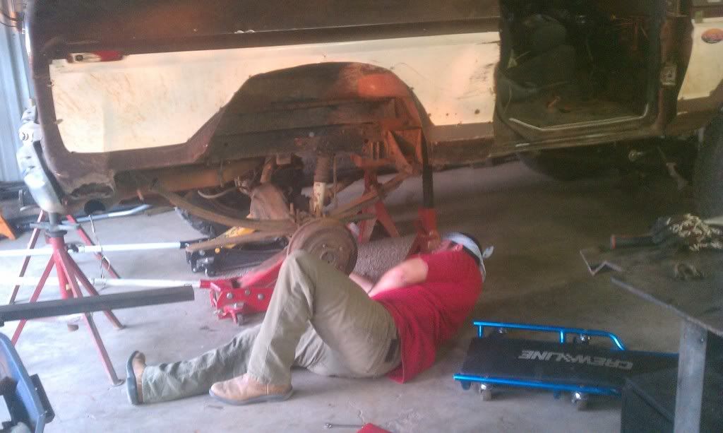

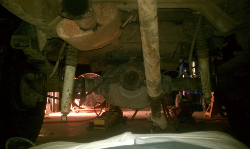

Matt and I got the rear done tonight. I love leaf springs, they're too easy.
http://i736.photobucket.com/albums/x...V/IMAG0113.jpg
http://i736.photobucket.com/albums/x...V/IMAG0114.jpg
Old u-bolts were a bitch so I just cut them off with a grinder and saved Matt some pain.
http://i736.photobucket.com/albums/x...V/IMAG0116.jpg

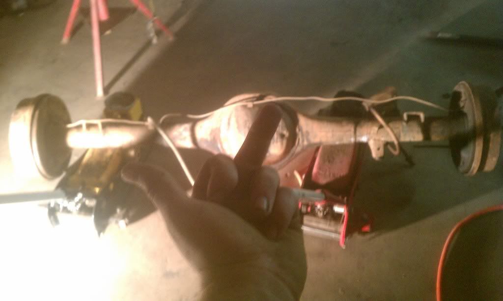

A salute to the 9". Never let me down until I really needed it. This thing is toast. The only good things left are the gears and shafts.
http://i736.photobucket.com/albums/x...V/IMAG0117.jpg
http://i736.photobucket.com/albums/x...V/IMAG0118.jpg
http://i736.photobucket.com/albums/x...V/IMAG0119.jpg
The stock shock tabs are held on with u bolts. I don't want that crap so I'm going to weld on some conventional shock tabs tomorrow.
The driveshaft will have to be shortened 3 or 4 inches.
What are you making the shock tabs out of? Why not just weld the superdookie ones to the tubes?
And go get the 37s swapped onto the front.
Gonna get a different yoke for the axle or add a flange adapter to the shaft?
