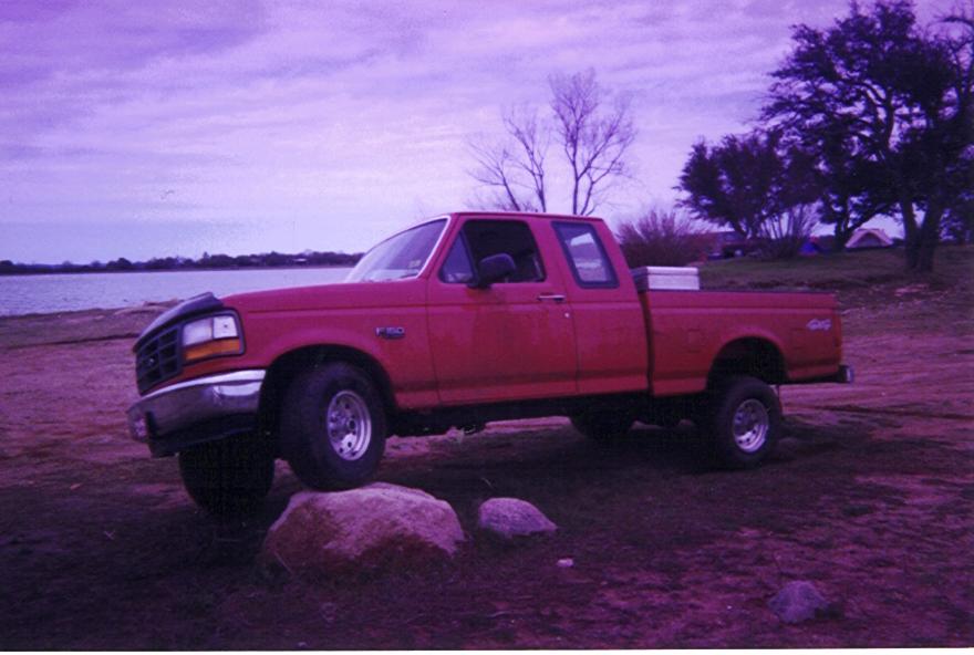

i'll save you the trouble....1st one is stock, my very 1st off-roading adventure in that truck. 2nd is after a body lift, 33"s and BLING! wheels....they were just polished tho, not full chrome like yours his appear to be.
i bet it got pretty good gas milage in this pic...

if i remember right it was ~15mpg.
but to keep this on topic, it had a Dana 44 front then too...TTB crap, but still...
