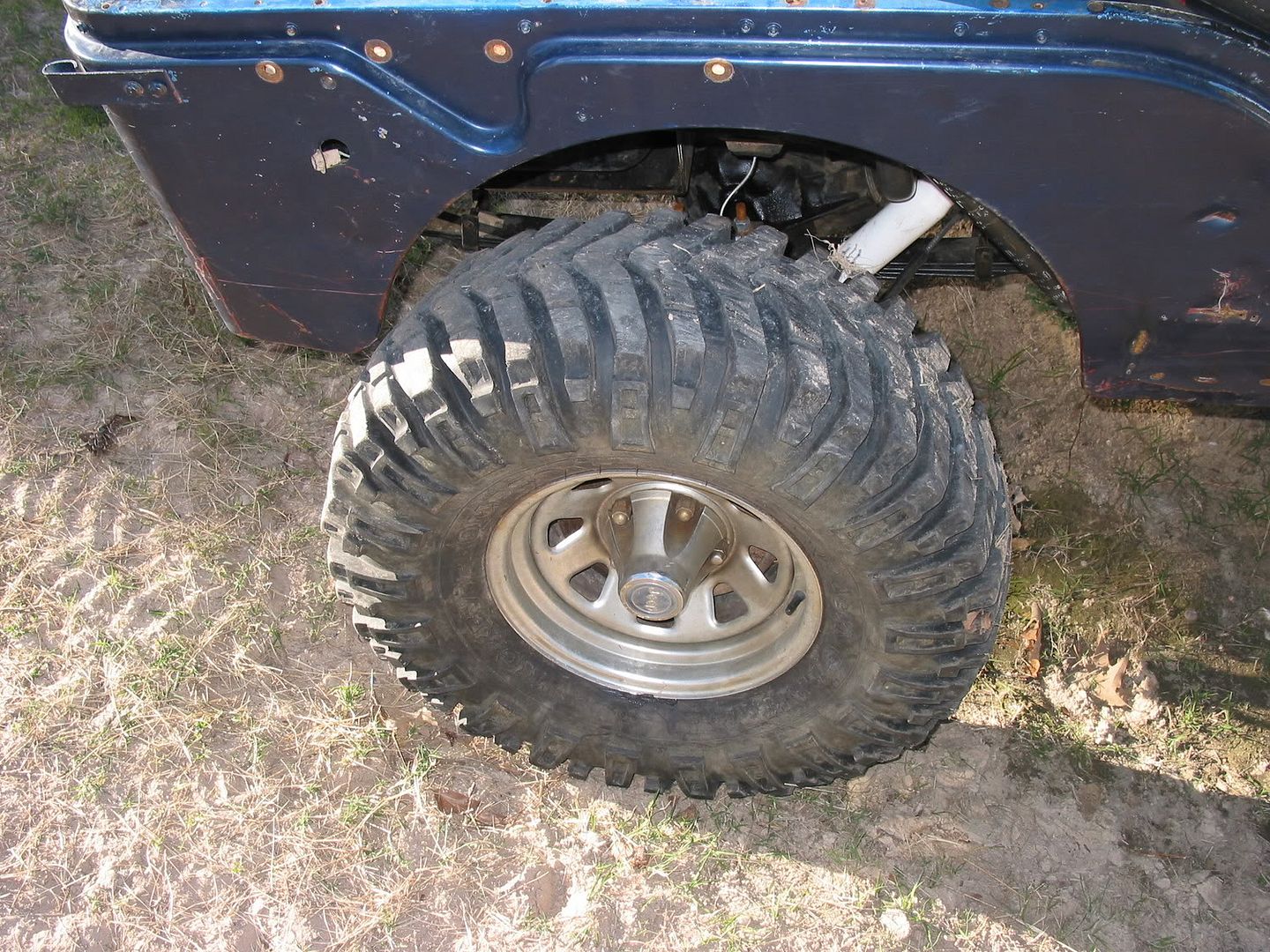

It's clearing by about an inch or so. But that's not fully flexed I don't think.
