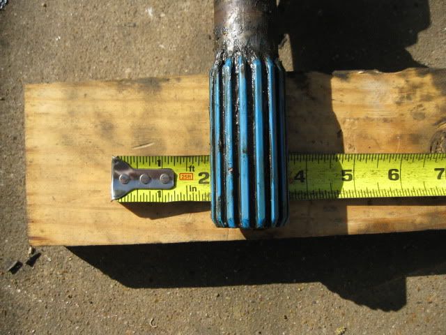

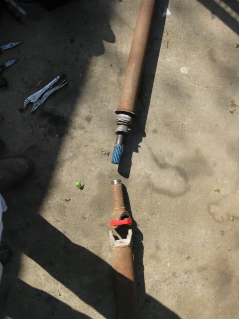

Built a new, hopefully straighter, front driveshaft today. It started with a two piece rear shaft from a Chevy LWB truck.
http://i135.photobucket.com/albums/q...f/IMG_0706.jpg
The splined portion of this shaft had a major diameter of 1.5"

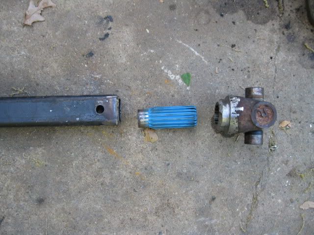

I am using 2" 1/4 wall square for the inner part of the slip, perfect. I cut the male splined part off the original shaft, it will be used to align the trimmed down yoke with the inner square tube before final welding.

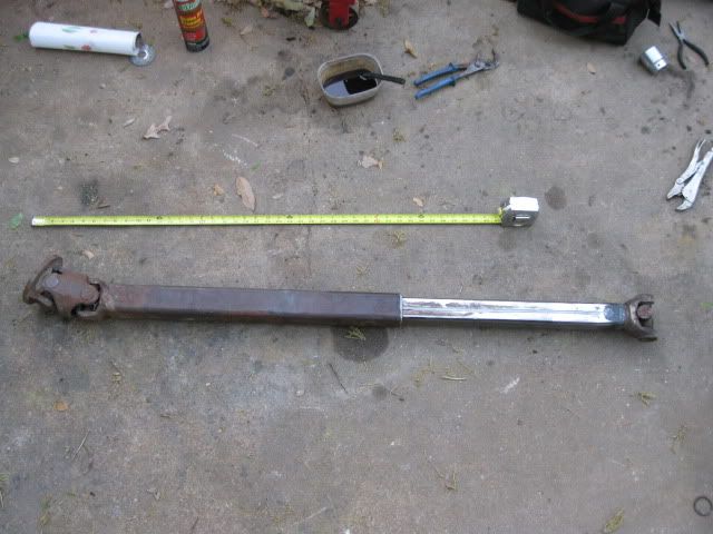

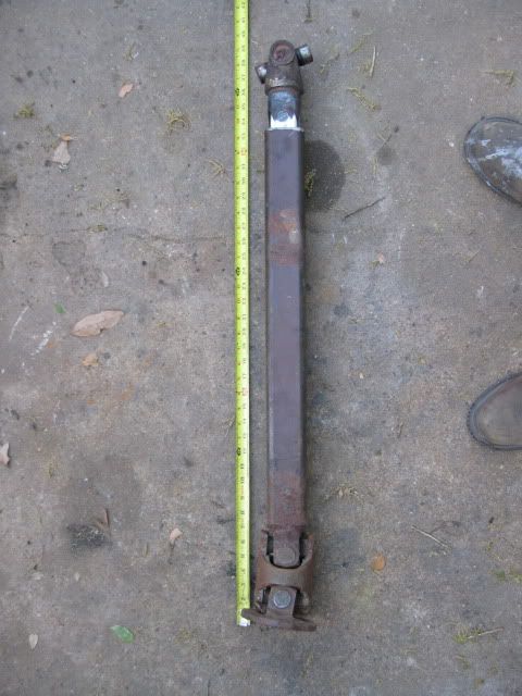

All done. ~38" long fully compressed.
http://i135.photobucket.com/albums/q...f/IMG_0709.jpg
A little over a foot of slip while maintaining adequate engagement. I used 2 1/2" 1/4 wall for the outer tube so a notch had to be ground into the inner tube to clear the seam.

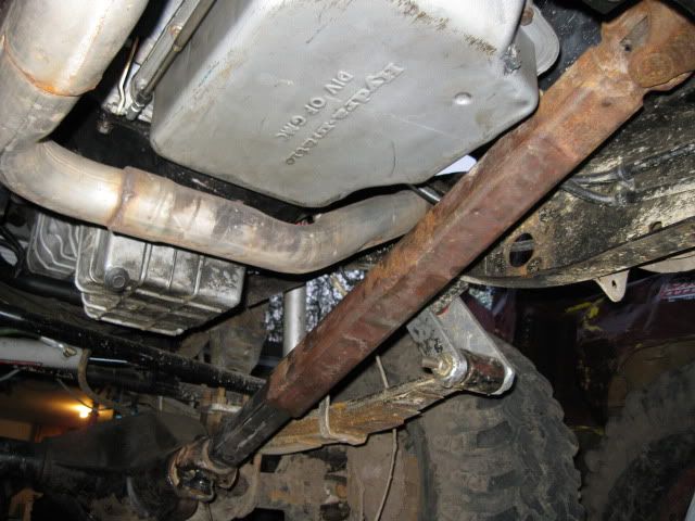

Installed and GTG.
http://i135.photobucket.com/albums/q...f/IMG_0712.jpg
that is going to grenade it self and you are going to kill a bus load of orphaned nuns....
The weight...is sign of reliability!
Looks good!
Got the truck up to 30-35 MPH in 4wd and the front driveshaft vibration is barely noticable. Much better than my old one for sure.
