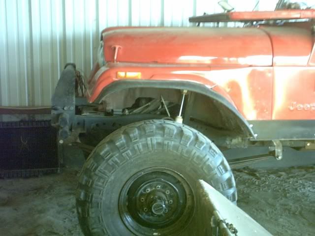

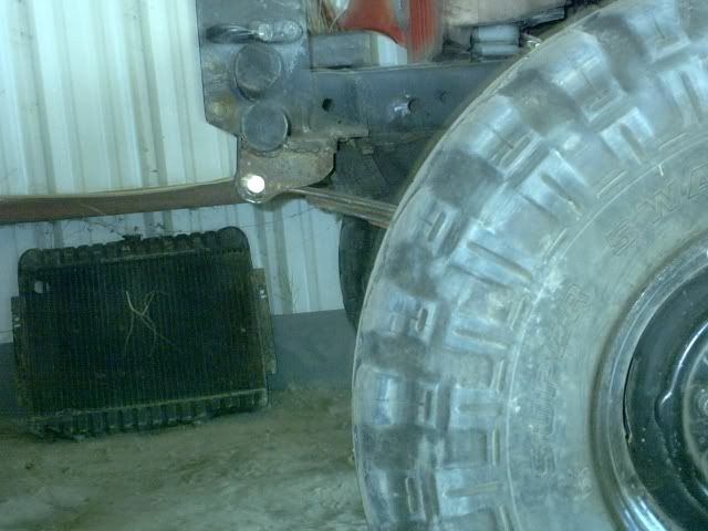

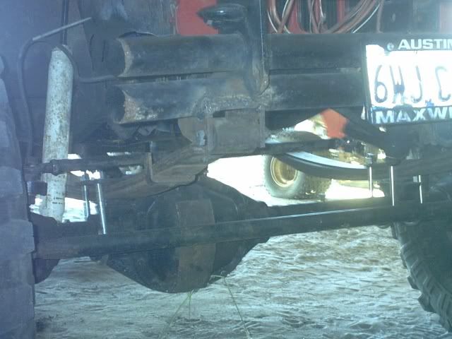

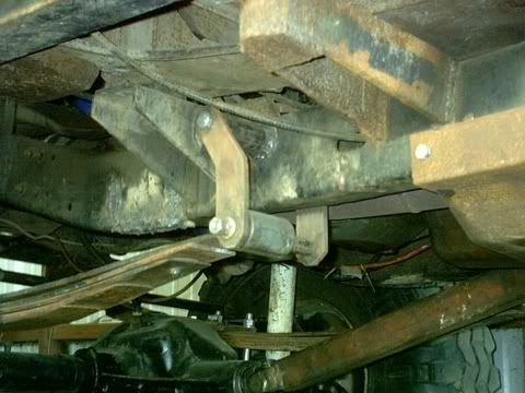

		Here's the front suspension pictures.  Much more clearance than before.  It now sits about 1" higher than it used to, plus whatever the tires added.
http://img.photobucket.com/albums/v1...uspension3.jpg
Notice the custom fender enlargening, and the spot where the old spring hanger was, no I haven't ground it smooth yet, but I've thought about it.

		those are nice, what brand are they?
		what are they?... am i dumb
		Summit Machine.
They are joints, for welding pipe to.
		orbit eyes.
http://www.aor4x4.com/orbit-eyepoly-eye.htm
can you weld to those? i figured they were oil impregnated or nylon and they wouldnt go well with heat.
		They are all the same design
