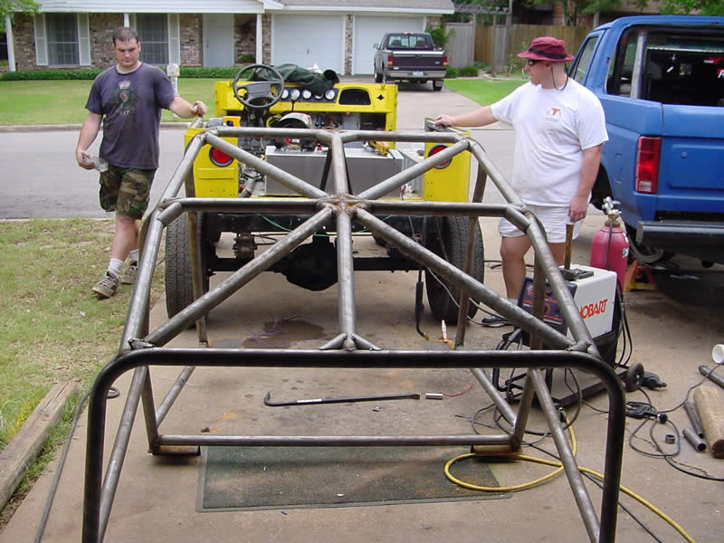

Replaced the fuel filters:
Top of the Tank - Wix 33003 (see through)
Between the Pump and the Engine - Wix 33481 (metal)
I need to:
- pack:
-- tow strap
-- tree saver
-- ice chest
-- water
- install the battery disconnect
- replace the power steering pump
- replace the leaking ram
- weld up the antiwrap bar
- replace shackles, probably all of them.
- rear tow point?
- spring bushings?
- floor?
- shocks?
IMO, a rear tow point is a must have
I have a workaround, it's the axle. I've used it to tow people out, like Scott on Saturday. But I also own D-ring mounts that could be put into the bumper. Just extra work. :)
It has a bumper?
You planning on doing anything about the winch rope? Seems to work fine as it is now, but I thought it was really easy to break the first time.
It's been a while.
A few biggies and a lot of odds and ends...
- Cleaned out rat poop and acorns. A LOT of both.

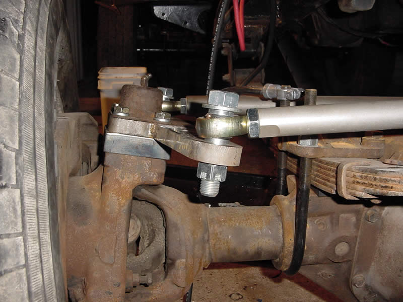

- Broke top off (rusted) to open tank, cleaned out rubberized crud from tank. Replaced filler nozzle. Replaced fuel filters. Replaced fuel pump. New battery. Fresh gas. Fired right up.
- Replaced steering ram and reworked tierod mount
- Made new shackles, all the way around
- Replaced from antiwrap
- Floor!
- Exhaust wrap
- Mounted a few dash goodies
- Mounted Klune switch
- New seat covers
- Missing headlight replaced and buckets "fixed"
Big thanks to Busa for multiple sessions and Scott for flooring expertise.
