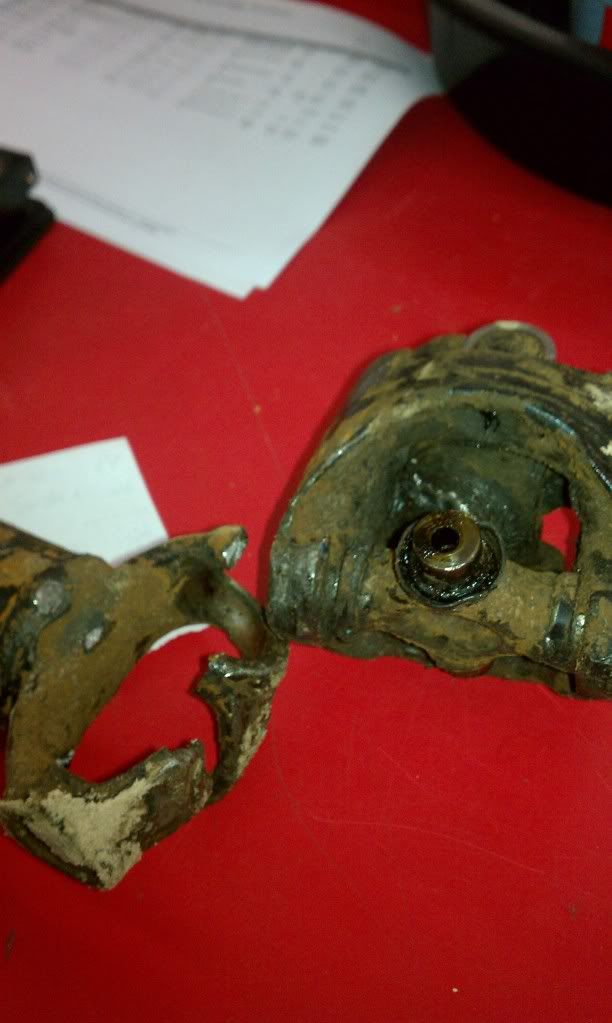

Front driveshaft finally gave up

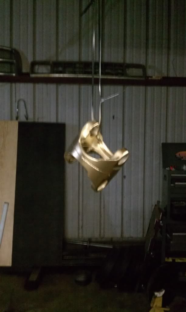

Tore down the new driveshaft today. Centering pin on the weld yoke looks good, centering yoke is still tight. All I need is some new joints and it'll be good to go.
http://i736.photobucket.com/albums/x...IMAG0049-2.jpg
http://i736.photobucket.com/albums/x...IMAG0048-2.jpg
Chromoly?, no thanks, 300m? ***** ****. 24K is the where it's at:grinpimp:
That will be worth a ton at scrap! :gigem:

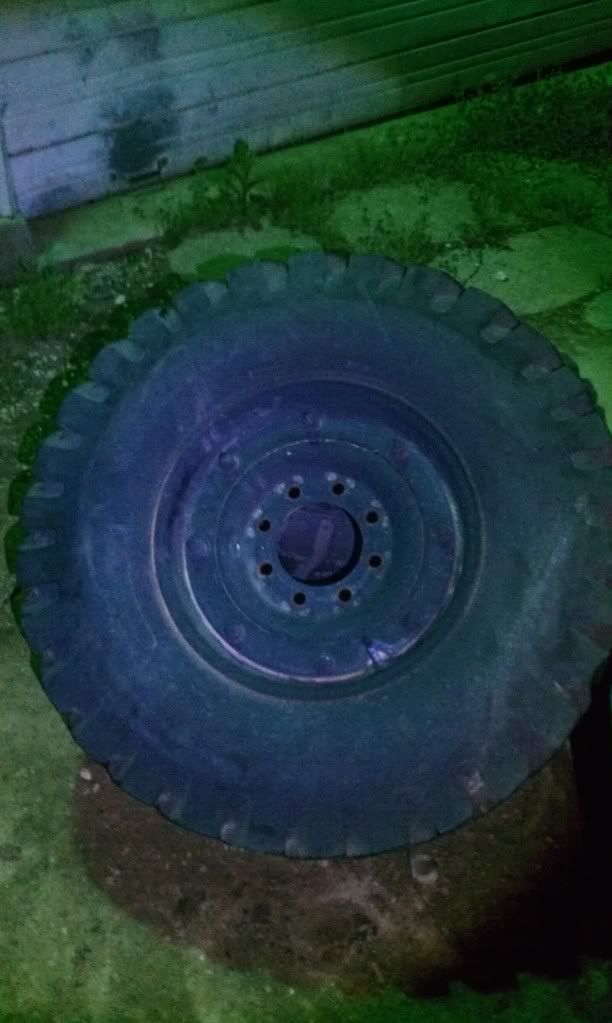

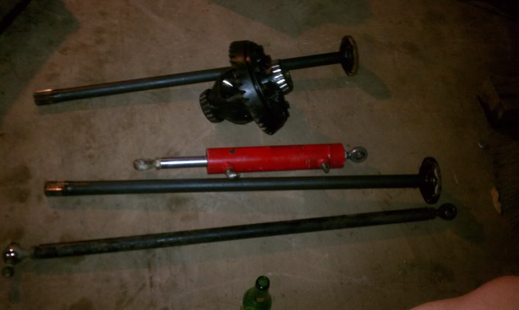

I went to burleson on my way home from the airport and picked up these, only 2 of them, but they were $50 for both with tires.
http://i736.photobucket.com/albums/x...IMAG0066-1.jpg

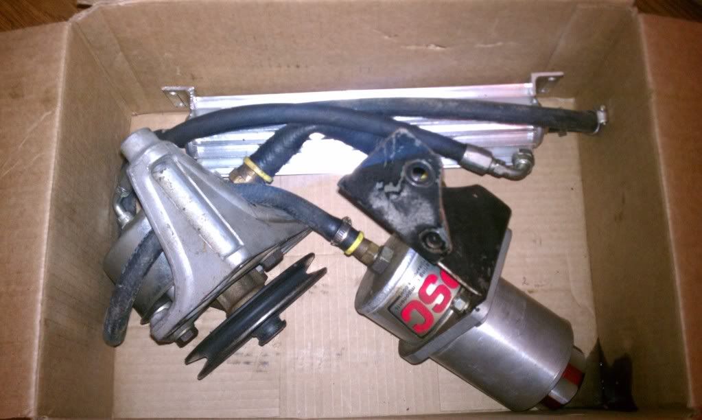

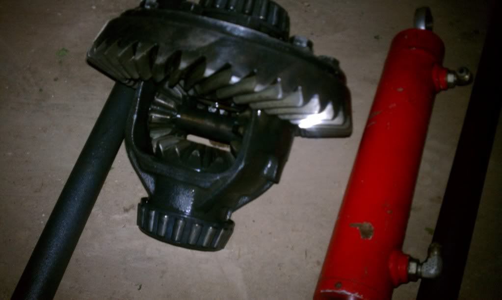

Then he started showing me other stuff he had for sale and I snagged all of this for $50
http://i736.photobucket.com/albums/x...IMAG0067-1.jpg
So now I have
-Half of the gears (front only)
-Half of the Steering ( need a ram)
-Half of the wheels ( need two more and some centers)
-Half of the body done
less than half the motivation.......
That's funny, keep it up :gigem:
edit- You also have Half a roll cage (roll bar)
second edit- This list can go on:
Half 42's (two bald)
Half headlights (one broker)
Half the way locked (just rear)
Half way on front suspension (longer shocks + softer springs)
Half bumpers (just rear)

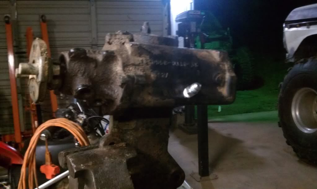

I have a PSC Ram that I need to sell. I think it is 2.25 x 8"

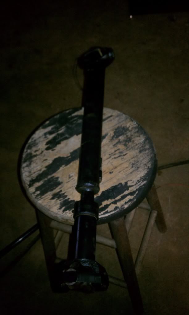

new driveshaft is in.
Tip:
Put the caps on the u joint before hammering in the caps on the top of the double cardan joint.

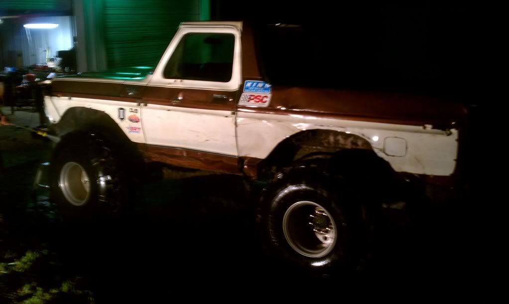

She's grounded from mud until october.
http://i736.photobucket.com/albums/x...IMAG0074-1.jpg
Pretty good for a couple of hours driving and $75
http://i736.photobucket.com/albums/x...IMAG0086-2.jpg
http://i736.photobucket.com/albums/x...V/IMAG0087.jpg
(This is the part where you say thank you)
Ok manners police. I said it in person. But thanks Scott.

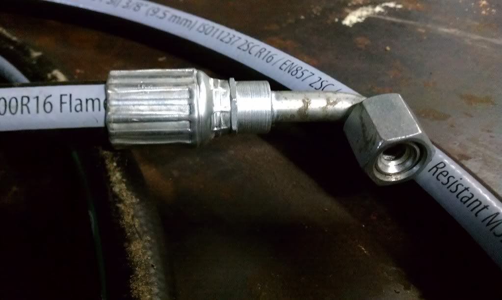

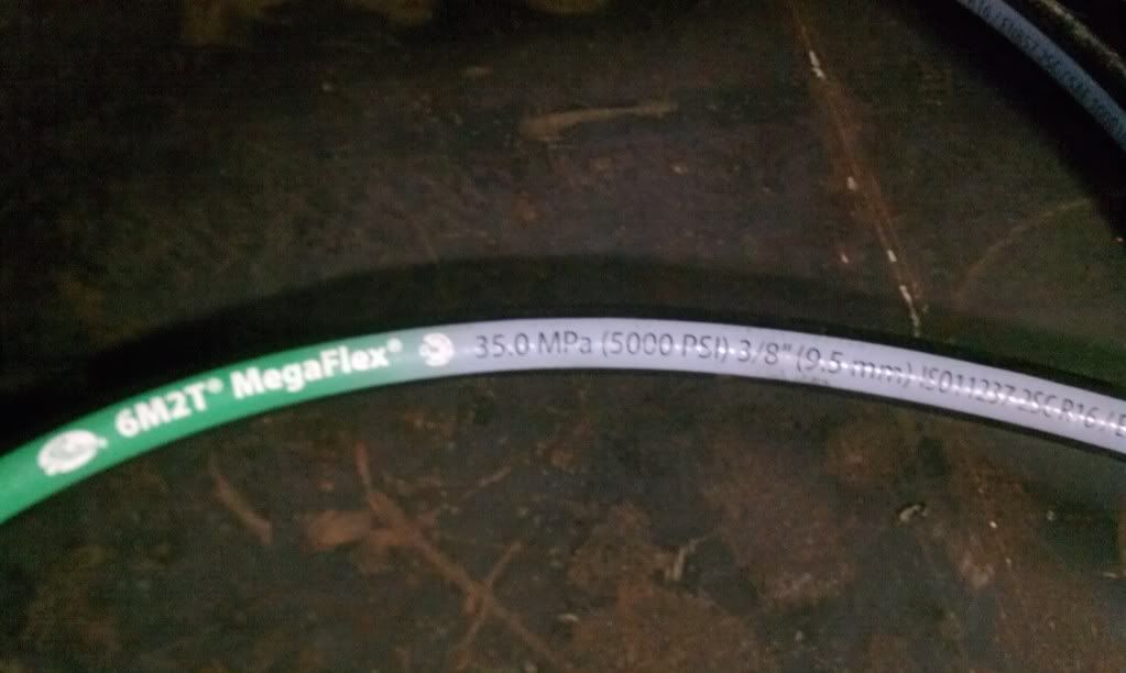

How long is that hose?
Long enough to do rear steer
