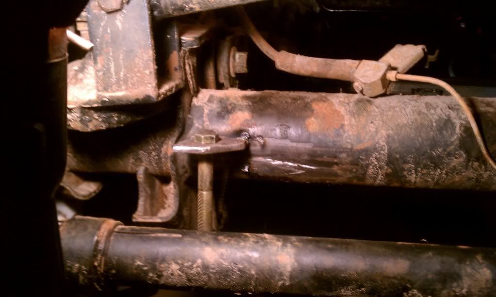

http://i736.photobucket.com/albums/x...IMAG0127-1.jpg
cut out some tabs. I need to add some internal stops to the ram because the tie rod only travels 6 7/8". I'll just rock it for now and knowing it's there.

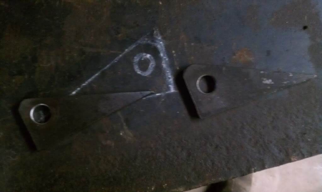

http://i736.photobucket.com/albums/x...IMAG0130-1.jpg
Tie rod tabs
http://i736.photobucket.com/albums/x...IMAG0131-1.jpg
axle tabs
