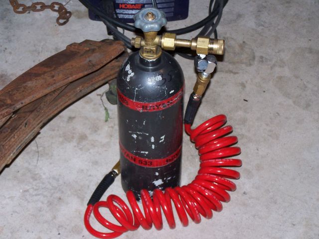

you can always build a CO2 tank setup for pretty cheap. Botco has the regulators, you can get the tank on ebay (harbor frieght had one in the close out section as well recently), and the hoses and fittings can be had cheap at HF as well
ok....tell me about that.
ya CO2 would be your best bet if all u want to do is air up tires

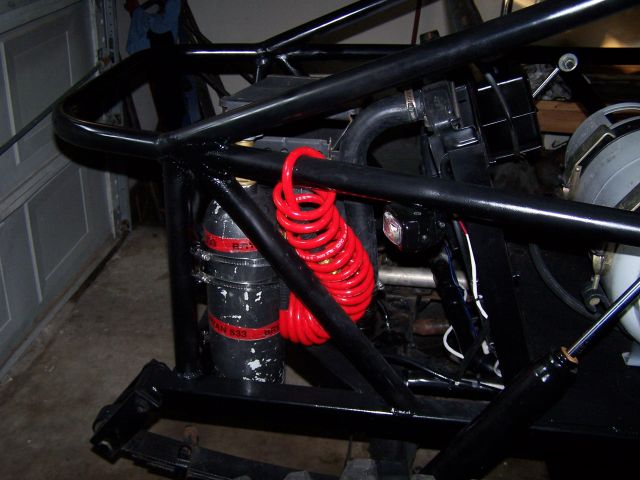

IF you want to see one you can come over sometime and look at mine. The tank is the hardest part to get. Ebay is a good source. You can get 5, 10, and 20lb tanks. I run a 5lb. I just had it filled for the first time, so I can't say how long it will last, but I know it will last much longer than a normal air tank. Creighton has been using one for a while, so maybe he can give you more info on how long they last. You may also be able to "liberate" a tank from a convienence store or something simillar. They're used to run the fountain drink machine. Then get a 100psi regulator from botco. They had several on the wall over by the welders last time I was there. Then go to Harbor freight and pick one of those hose kits that come with all the fittings, and a gauge if you want it, and you're good to go. The nice thing is, these things are relatively small and compact, plus they're mobile, so you can carry them to other rigs. As for price, I bought the tank for $40, the regulator was around $40, and the hose kit was $15 (but I got the one with the better hose). I think it was 9 bucks to fill it at brazos valley welding supply on 2818. I built my own mount for it. Here is a pic
http://www.tamor.org/members-rigs/al...3/100_0025.jpg
Supposedly you can also run air tools with this setup, but I don't know if the regulator from botco will work for that or not. Perhaps do a search on pirate for more info. Another thought on the tank. Maybe try checking with Brazos valley welding supply and see if they will rent you a tank for a few dollars a month, and then you could just come trade it in for a full one when its empty
