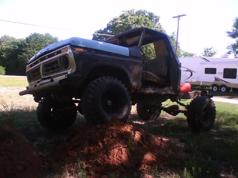

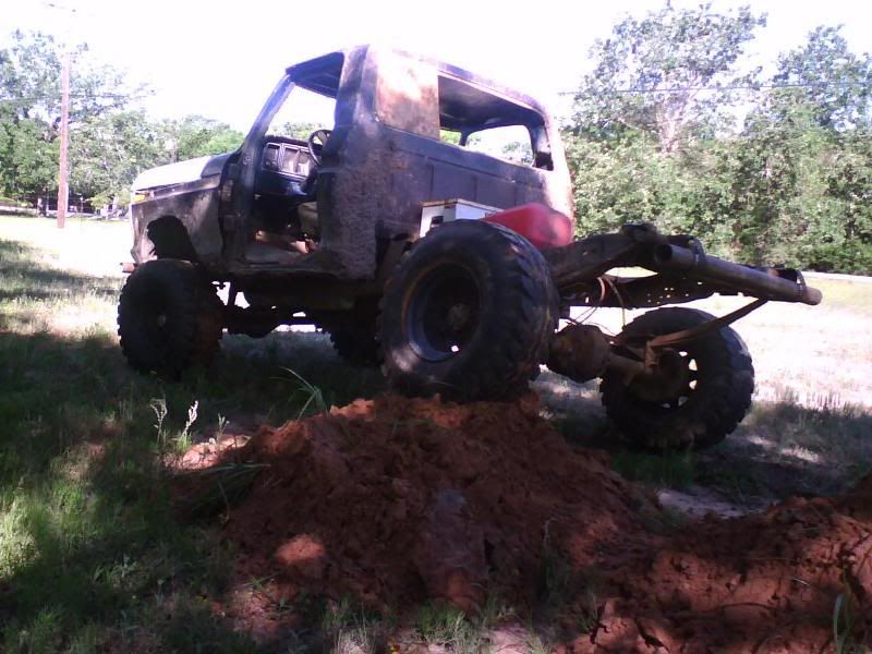

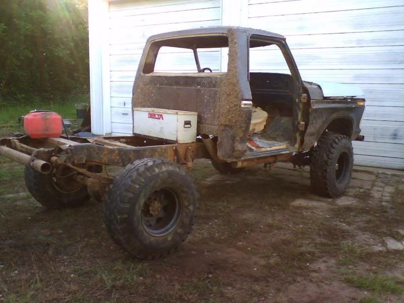

Added:
-lap belt for driver, Idea is to keep me from falling out yet still allow me to lay down incase of roll over.
-box

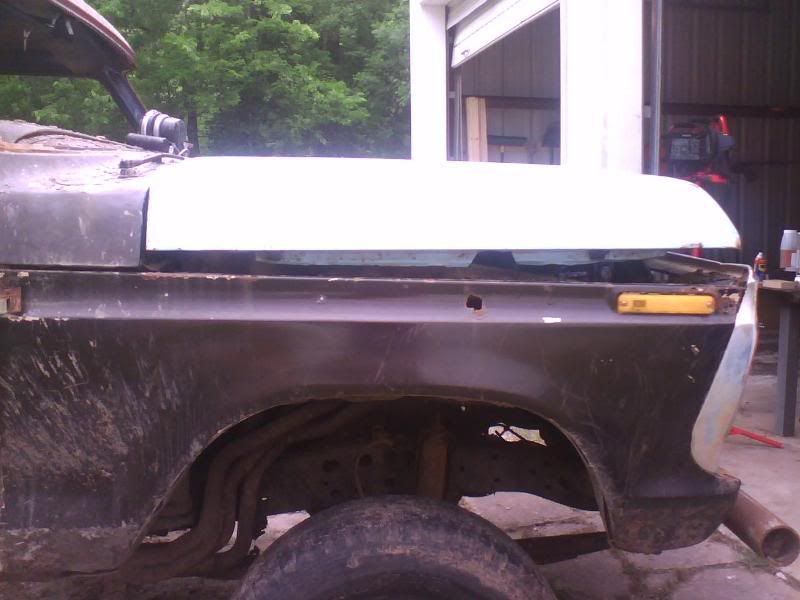

-hood, welded the latches on due to lack of threaded bolt holes then bent them(latches) today in a test jump.
-hummer tires, hold air for the most part
- finished welding the rear bumper, front is going to be ground off and reconstructed for leaf spring mounts
-got brakes working slightly better, will be swapping in a 1 ton booster and master cylinder later.
-plywood shield

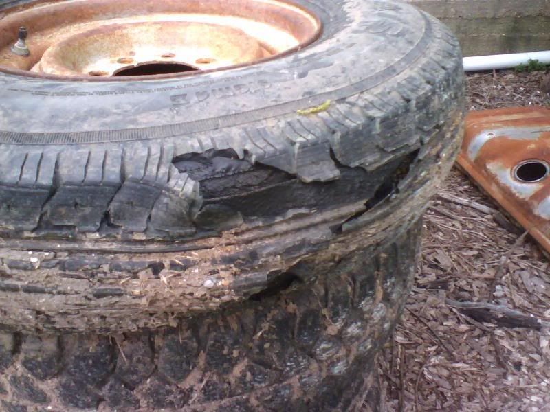

One of my sweet custom tires had a blow out, It wasn't even holding any weight up.
http://i246.photobucket.com/albums/g...ireblowout.jpg
