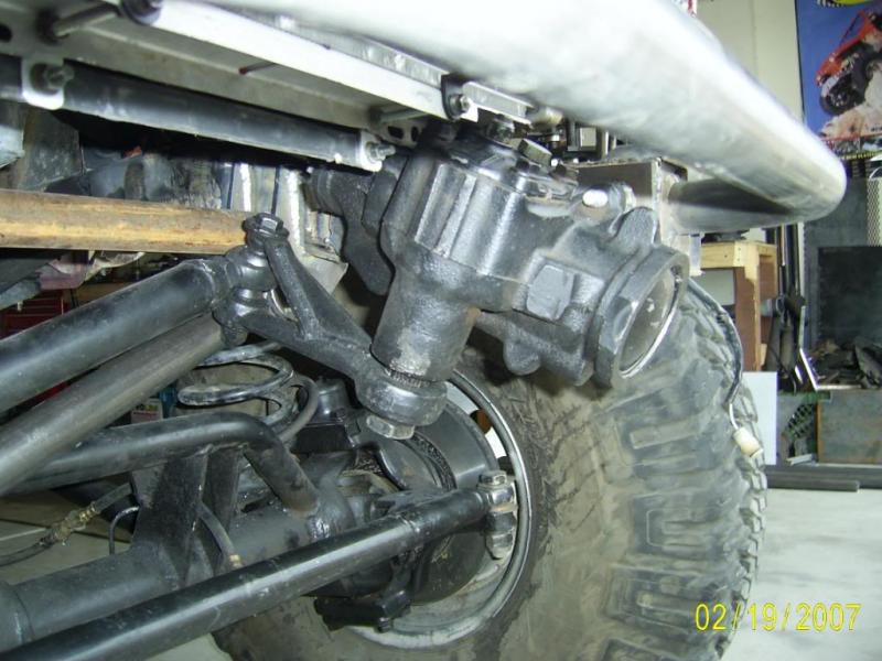

Alright guys, currently running "inverted T" (draglink to tierod) steering with GM 1 ton TREs.
Getting ready to start my 3 link and wanting to make sure I can get panhard bar and draglink on same angle. With my current steering set up I'm going to be squeezed real tight for space and proper angle.
I'm thinking about switching my steering to heims and on the passenger side running a single bolt through the knuckle with tie rod mounting below the knuckle and draglink on top. This would free up some space and allow a little bit of front stretch.
BTW, its a full width 1/2 ton HP44 with stock knuckles. I really don't want hi-steer so I can keep this rig somewhat low, and trying to keep from notching the frame.
