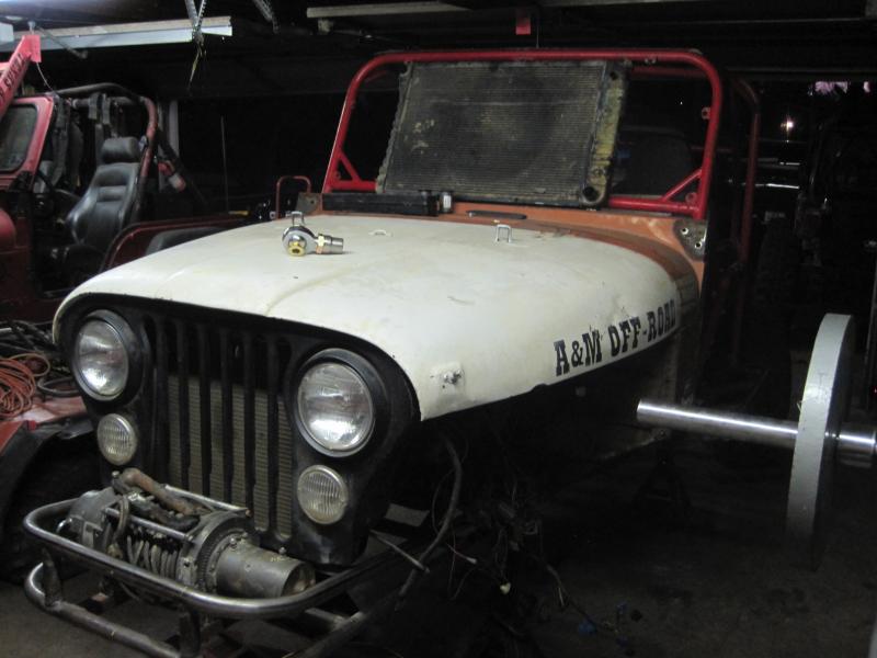

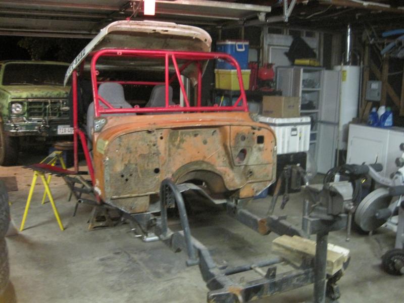

Since the blazer has seen better days I picked up Scotts old chassis and am going to put all of the good parts off of my blazer into it.
Parts from Blazer:
TBI 350
700R4
Klune (2.73:1)
205
Front Dana 60 4:10 gears and detroit
Rear Dana 70 4:10 gears welded (may swap out for a srw 14 bolt so I don't have to run spacers on my front)
OBA
I plan on linking it front and rear, and maybe using some sort of exotic material for links depending on cost. Air shocks on all corners.

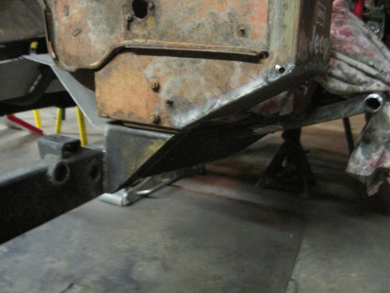

The only major changes I am going to make to the chassis is the front will get cut off and redone with tube.
