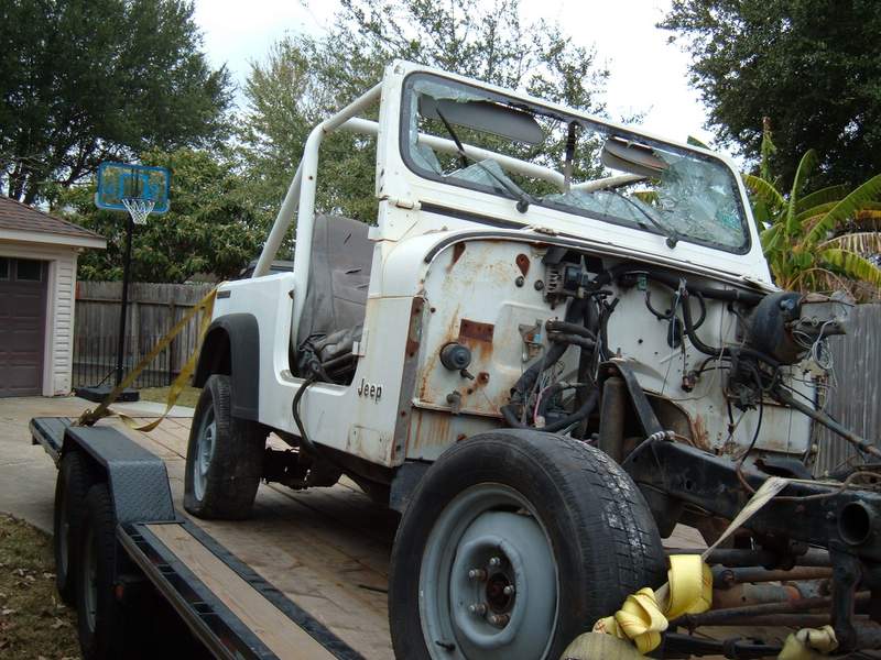

The plan:
YJ tub and Frame with CJ grill and hood.
Vortec 5.3 / SM465 / Atlas?
leaf spring all around
Ford 9 rear, 35 spline
Ford 9 front, 35 spline (this depends on time and money)
40" tires, H2 wheels
The plan:

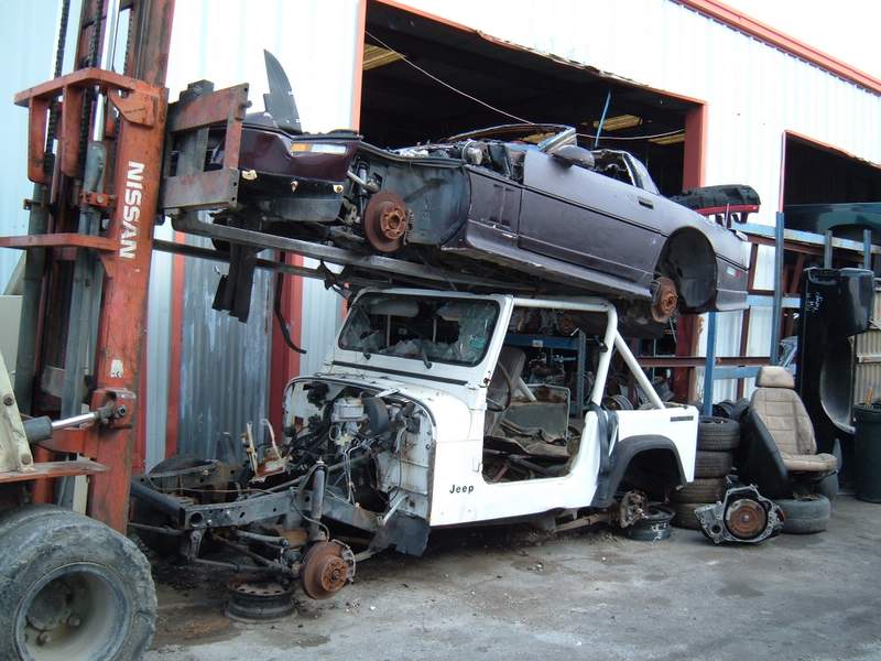

there is always a reason some things are in a junkyard!
wtf? Is that one you guys got?
no. it was on pirate.
that would cause a small miss
what a mess.

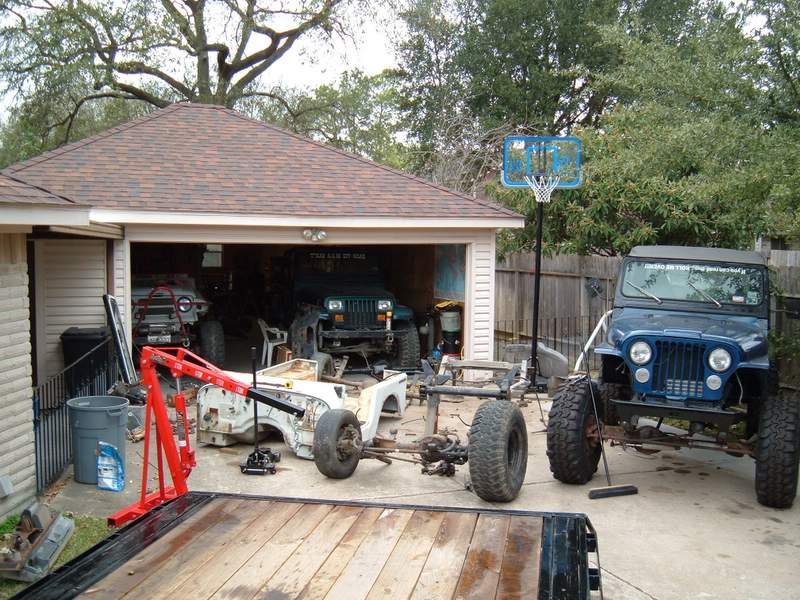

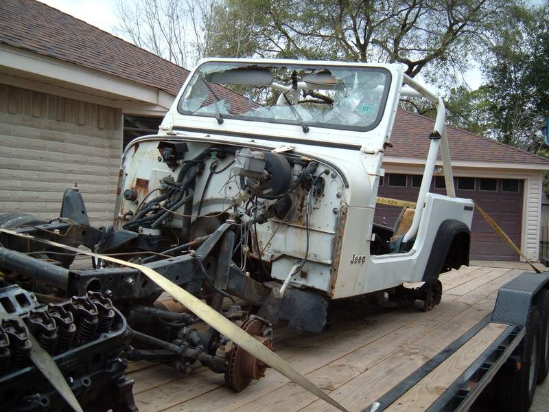

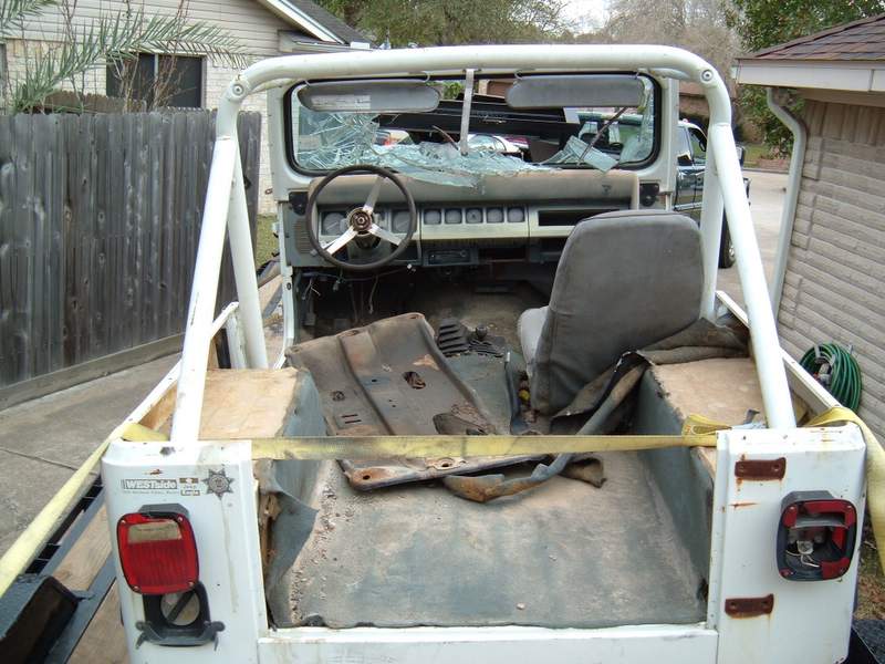

Teardown is complete. Now it's time to cut and grind all the crap off the frame and to scrap / blast all the glue (they glued the carpet on) off the body...
Just out of curiosity how did yall lift the tub off the frame?
probably two people lift it... they are pretty light are they not
I did it myself with an engine hoistQuote:

did i miss something? Who's CJ is in the driveway?
his but he is selling it, cause he doesnt want to rebuild that one.
thats a nice looking garage and driveway that youve got there
