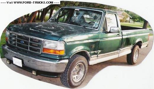

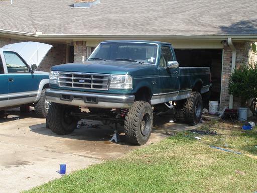

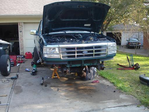

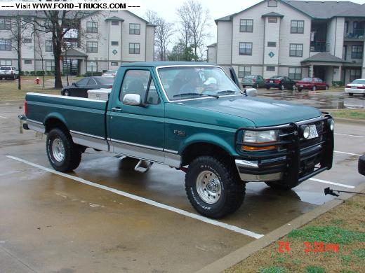

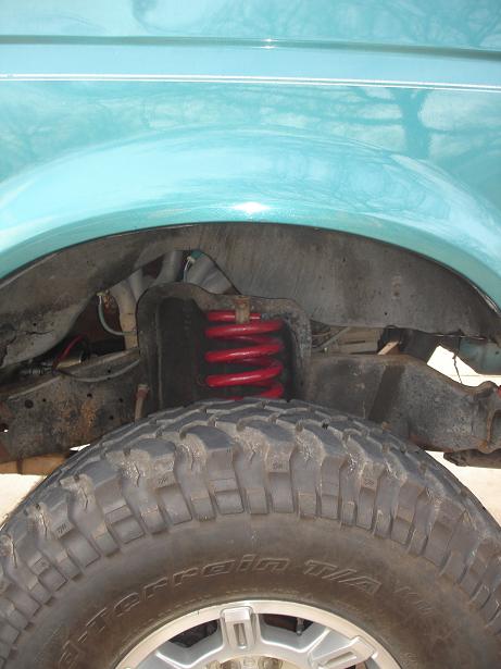

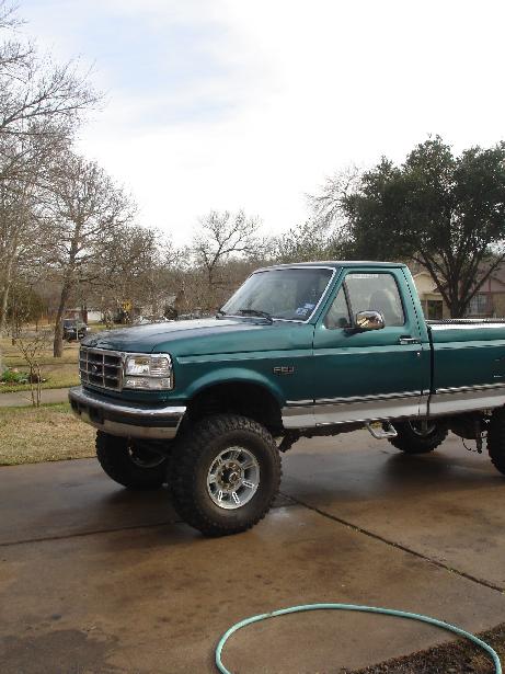

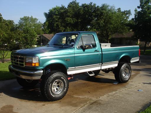

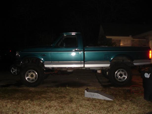

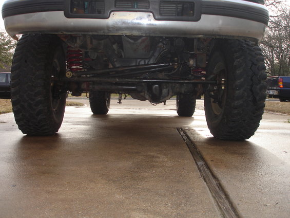

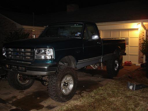

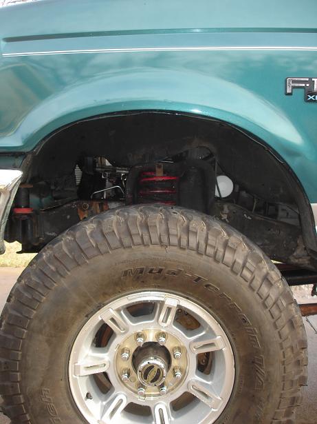

started life as my dads stock 2wd f150. i lifted it a little, then a little, more then a little more. untill it became this thingy. finally got around to installing all the parts i've been collecting for a while. lots of little things still need to be done. will get more indetal later

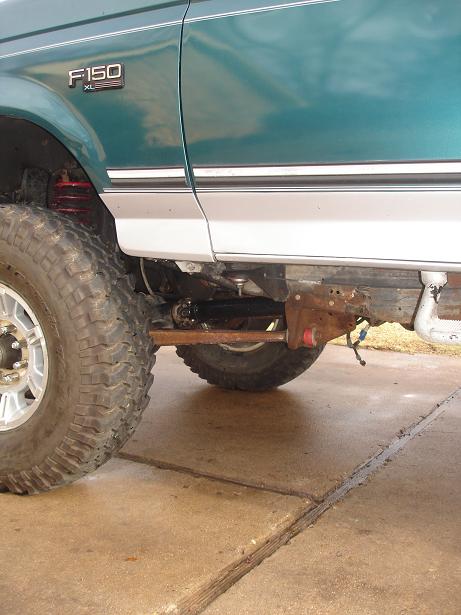

8 lug 44
sterling 10.25

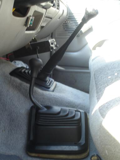

zf-5
1356 tcase
36 12.5 r 16.5 H1 tires
