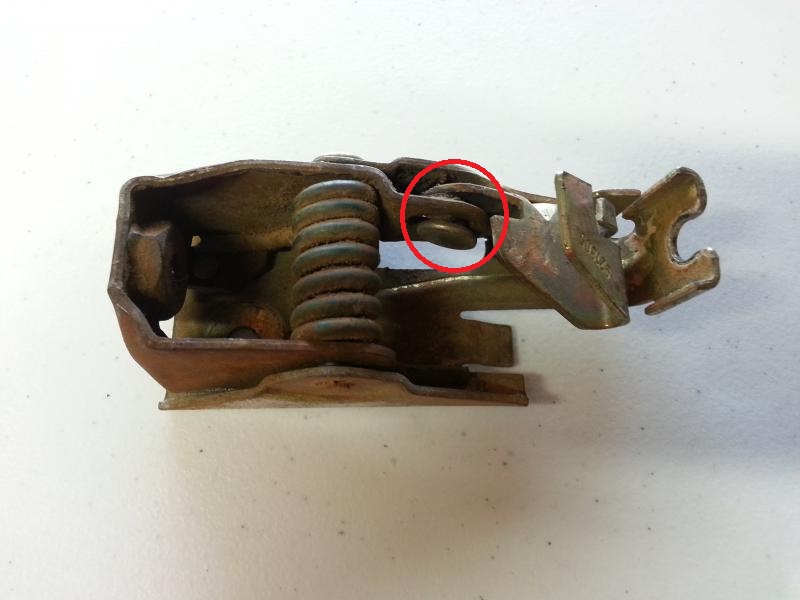

For the drivers door. Anyone have this in town?

Check doggetts, they usually have/had a f series truck in their lot. I'd also double check and make sure the door sheet metal isn't tearing and if it is weld it or use big ass fender washers when you put it back together.
Door is OK, the circled rivet has "wallowed out" the hole and has so much slop that the door won't open using the handle.
Attachment 19542
