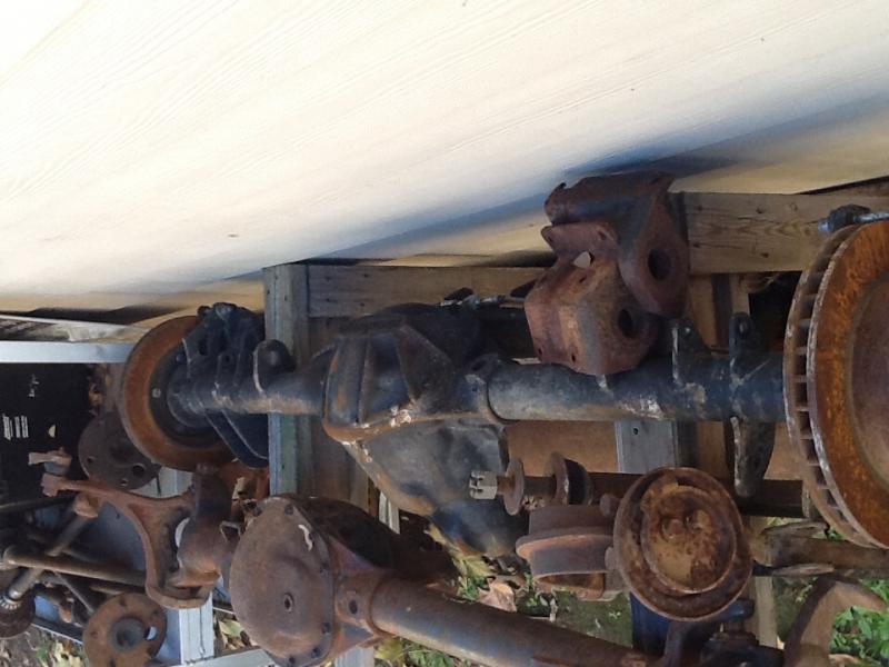

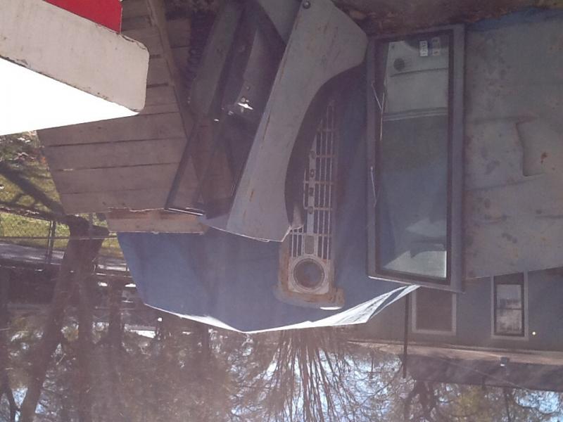

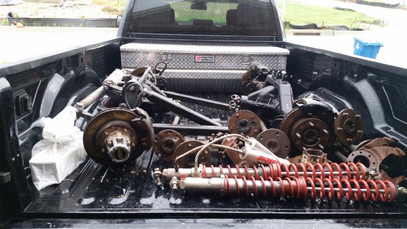

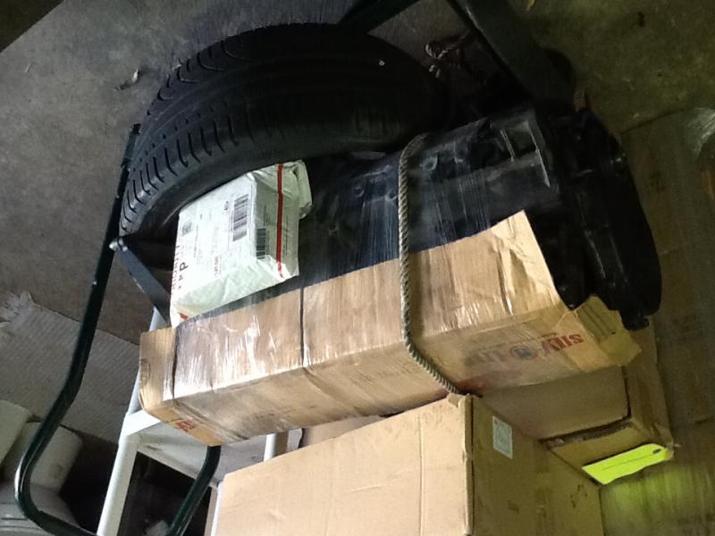

5 Attachment(s)
the first is the short block
that second picture is of the jeep hibernating under a bunch of early bronco parts
i'm not sure why some are upside down. stupid ipad
