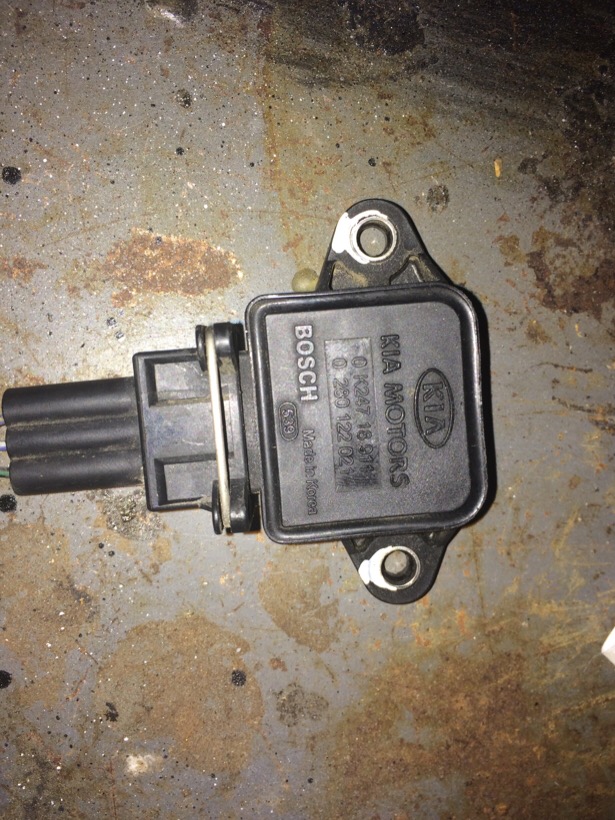

Still finishing up all of the details. It's been running very rough, high idle, stumbling when the gas is hit. I suspected it was lack of throttle position input to the ecm since the 1.6 uses a throttle switch that tells the factory ecu idle and wot with nothing in between.
I went through every tps I could find at pick n pull and a Kia sephia was the winner. Same plug, same shaft diameter, just needs a spacer with a different bolt pattern
It's running much better with this setup
