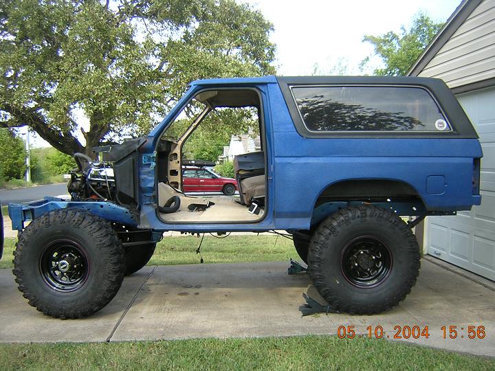

ok i figured i would start a new thread because i all my other ones were messy... this is the start of the buildup at Richards St. this is how it looks right now
first thing i am gonna do is get the garage cleared out and move the chasie in... the tub/top is going in the back yard... next is to get all of the drivetrain put in and all the breaklines ran and what not... i am gonna need a couple (more like 5) volunteers to help me move the tub and then i can get the ball running on this project again

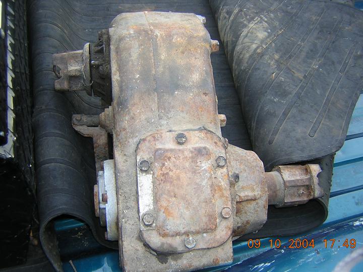

i got an np205... just need the 203 now
Piomp. 205's are sweet. When are you gonna remove the body I'll see if I can help.
how much did you pick up that 205 for?
i got a pretty damn good deal... lets just say i paid less than i was willing to pay... and the guy went down much more than i went up in the negotiation process

i am moving the front hangers for the rear springs back ~2"... this will fix the problem i am having with my shackles
well that didnt take that long at all.. here are a few pics... i think it turned out great... and it added a couple inches to my wheelbase
so is your rear shackle angle better now?
hey tate why did you do this, if i remember right if your rear shackles have some angle like maybe 35-45 degree angle it allows better flex, i think by moving that you lost some down travel for sure. i dunno i could be wrong someone corret me.??
Originally Posted by stx4wheeler
it was angled forwards not backwards before he moved it..
i think if it was left alone then it would of caused a reversal, right?
Your frame looks like a bassboat. According to Mr. Foxworthy, rednecks are attracted to shiny objects.
The shackles were angled wrong before, it wouldn't have gotten any downtravel much. When he puts weight on it, it'll probably sit perfect now.
yeah it was all messed up... they were at max forward sitting on level ground... it wouldnt have flexed at all... they are exactly where they need to be now
