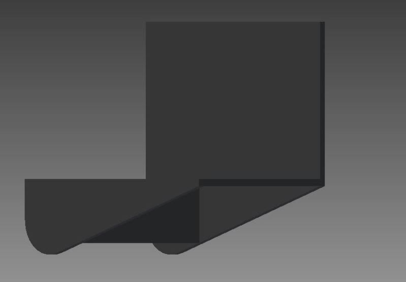

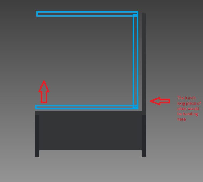

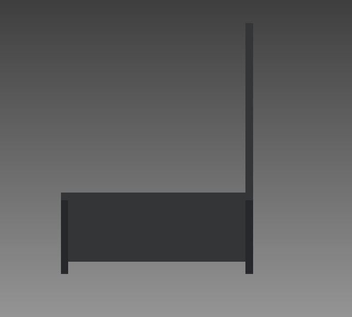

I don't follow you on the top bend rotation thing, as for the extra bracing I'm just going by what I see here http://www.tamor.org/forums/showthre...l=1#post278348
You can see the small bracing tab that welded to the tabs the hiem bolts to... I'm sure that is clear as mud too. in order for the bottom to bend up the large piece of 1/4 inch plate would be the weak part.
Originally cage defected from James diff and started knocking off there arms and offered a backer plate that went inside the frame and was basically a small piece of angle. They said it was to prevent the bolt holes from wallering out and being that are bracket is twice the size with more bolts I didn't think we would have much problem
I saw that tab, I still believe the brace is necessary.
that top rail doesn't have much weight on it, it would move with the rest. just about every mounting point on a chassis is on the side.
FYI, It's easier to say "I don't feel like doing it" than to draw stuff in paint
After some more digging I found Cage's improved RA mounts which did not require a backing plate, These appear to have came out in mid 2007 which is right around the time they went bankrupt, hopefully that wasn't caused by faulty RA mounts. I haven't found much feed back but I think Tommy will be fine with what he has and we can keep moving on for now.
Now to prevent confusion, I think a backing plate is a much better idea than boxing the frame or a new cross member but we really just need to get this thing out and rolling again. Then if we feel it is necessary we'll add one.
lots of google image searching to justify "I don't feel like building it" The paint would have been dry by now.
