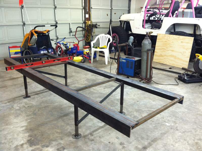

    Built a Table to work off of:

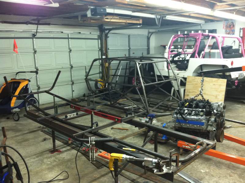

    This is where I got after one day and one night on the chassis.

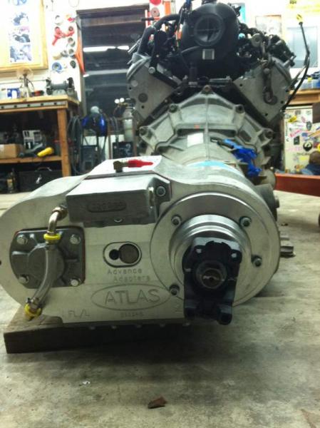

    The t-case dropped down a few degrees
    I changed the T-case back up to 0 degrees for a better two piece driveshaft angle at the bearing

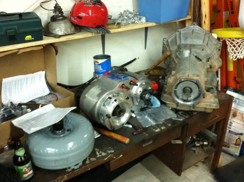

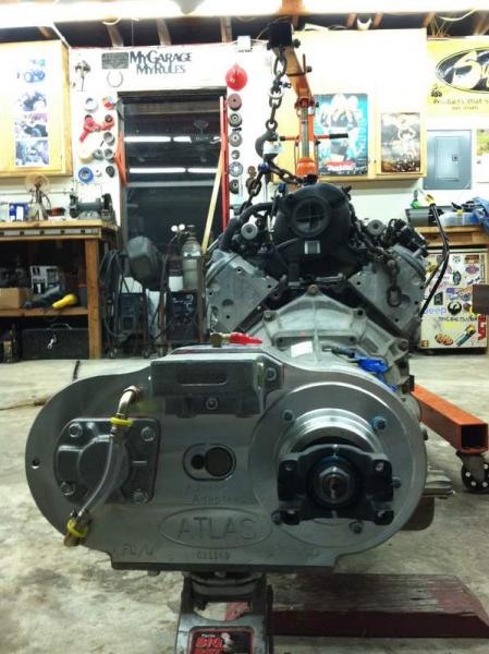

    Putting the tranny and t-case together

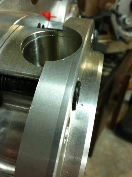

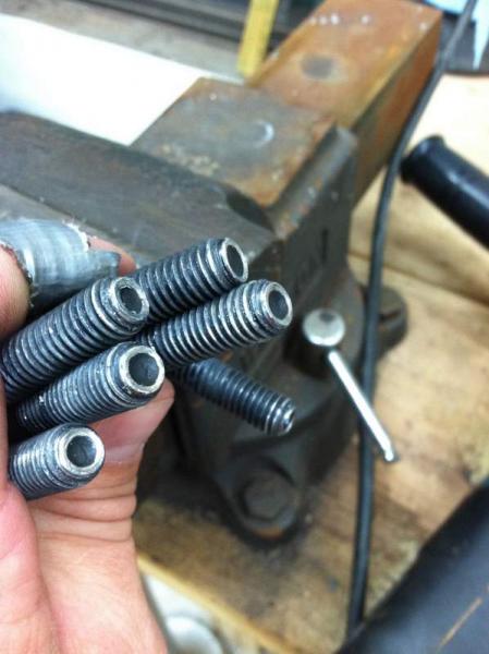

    The adapter bolts were too long - they bottomed out:
    Notice the AL on the end of the bolts - I cut them all down

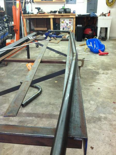

    The first two bends done on the first piece of tube, slightly overbent on second bend. I was able to fix it

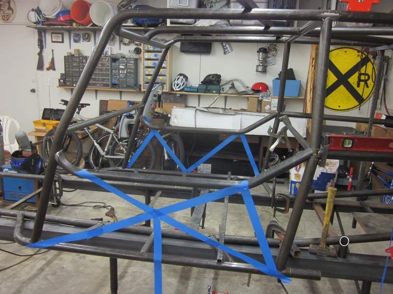

    where should I put my braces under the door bars?

    Passenger side pattern looks cleaner to me.

    I like the yellow lines but I think I'm going to add a window "vent" bar coming down from the top "A" pillar bend. I need something to intersect down there in the door.
    Update - I got the subframe done - at least all of the bends and notches, just need to add all of the 1.25" small bracing.
