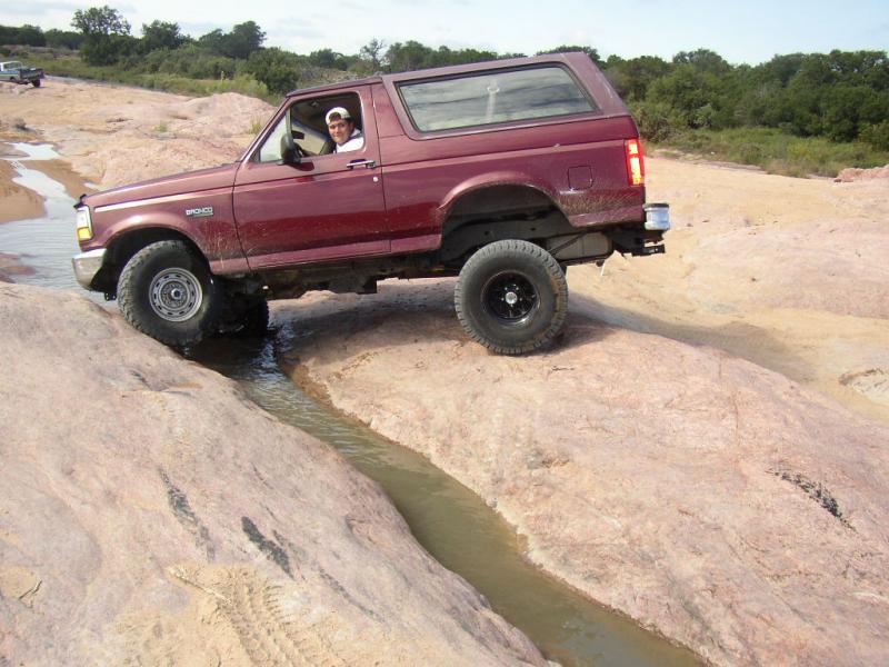

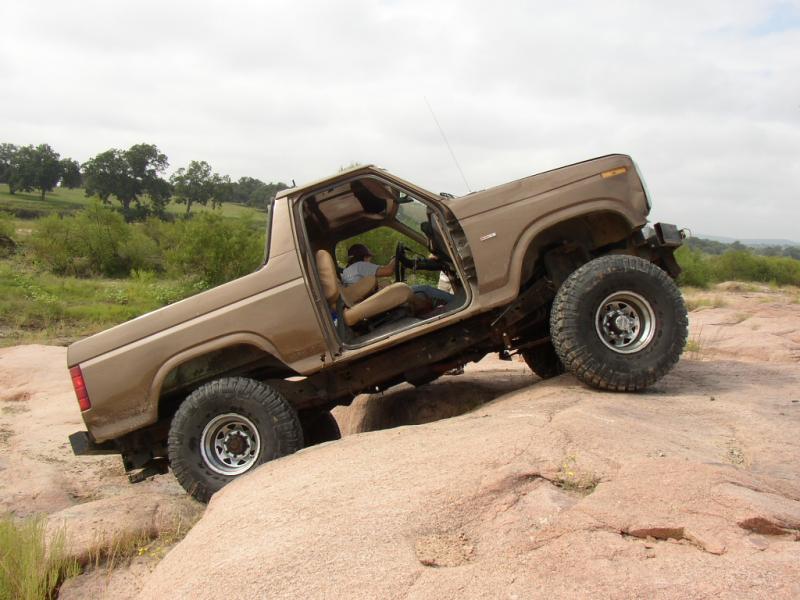

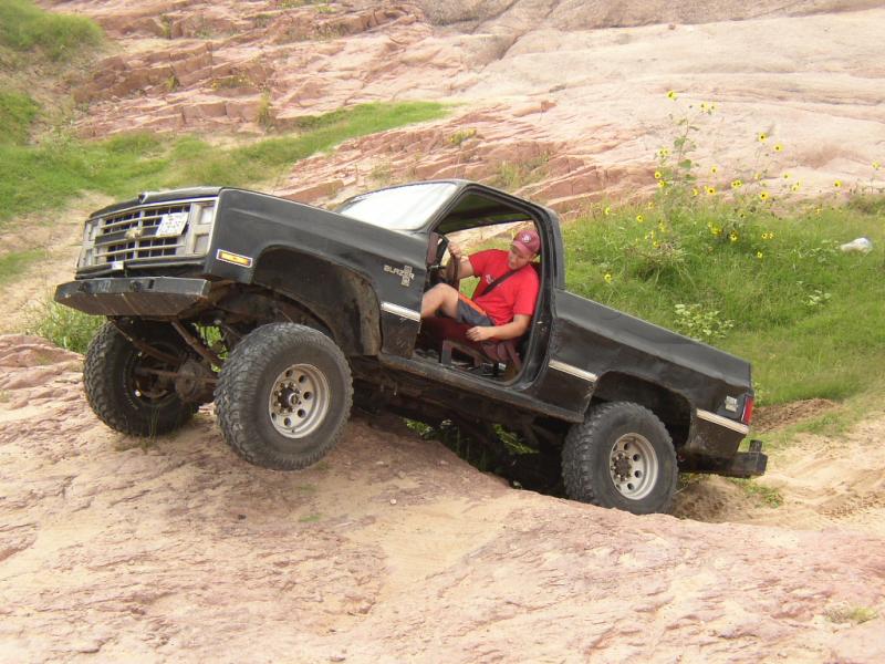

    My Bronco had a 3" lift and I ran 33X12.50's. I had to cut the edge off the bumper because it rubbed, other than that it did not rub. The Klogger in TTB form, which essentially the front is a bronco ran 37's with a 6" lift with no issue.
    Also my Bronco was actually somewhat "nice", like I had balanced tires and did regular alignments and it drove like a giant piece of ****. Even before the lift with 31's it sucked. I mean you could keep it on the highway, but like it would not do a straight line so well.....
    You can see the bumper trimming here...
