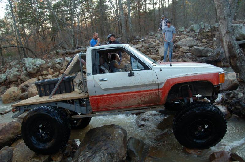

    I plan on making the toyota streetable so I can drive it and not just leave it sitting in the yard all year since I don't have much time to wheel.. So far it needs;
    title and registration
    correct turn signals
    permanent brake lights, right now they're just towing lights
    front bumper
    maybe paint to stop the rust
    speedometer
    Help: I know I can do some research but wanted some suggestions from yall with actual experience. I'm running 37" hummer tires and still have stock axle gears. The transfer case has low range gears. What axle gearing should I look into? Also has anyone been harassed by cops for running forklift tanks?
    right now

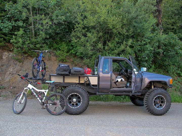

    inspiration

    finally got it titled, should have done that a long time ago. I'm going to leave the axle gears alone for now and try them out as they are. Next plan is to bend a roll bar and some pieces that go to the rear of the frame then build a bed with toolbox and two propane tank mounts hidden between the side toolboxes.
