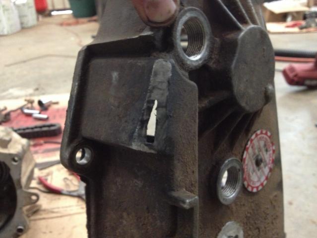

    Transmission mount wore out and caused the skid plate to wear a hole in the t-case.
