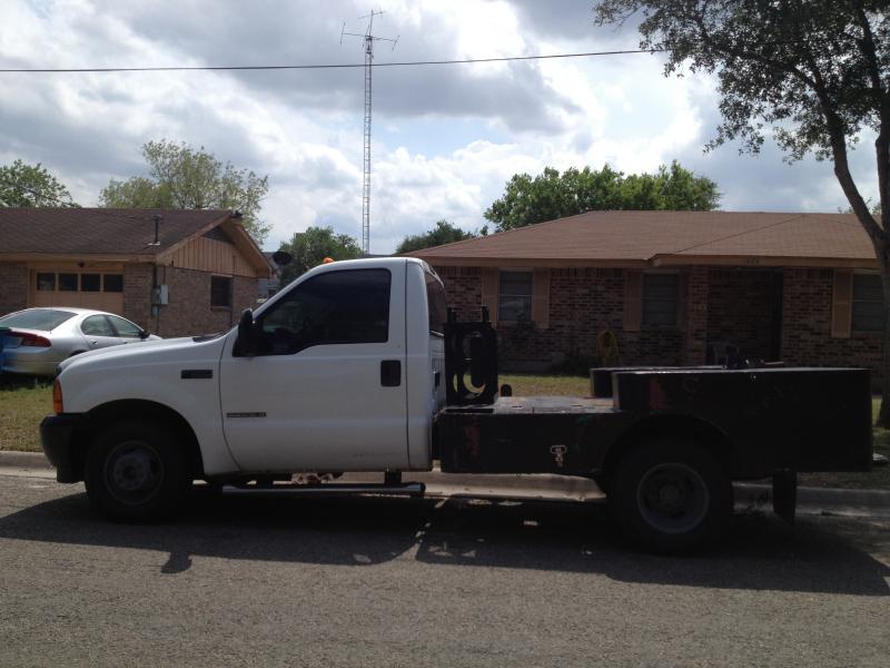

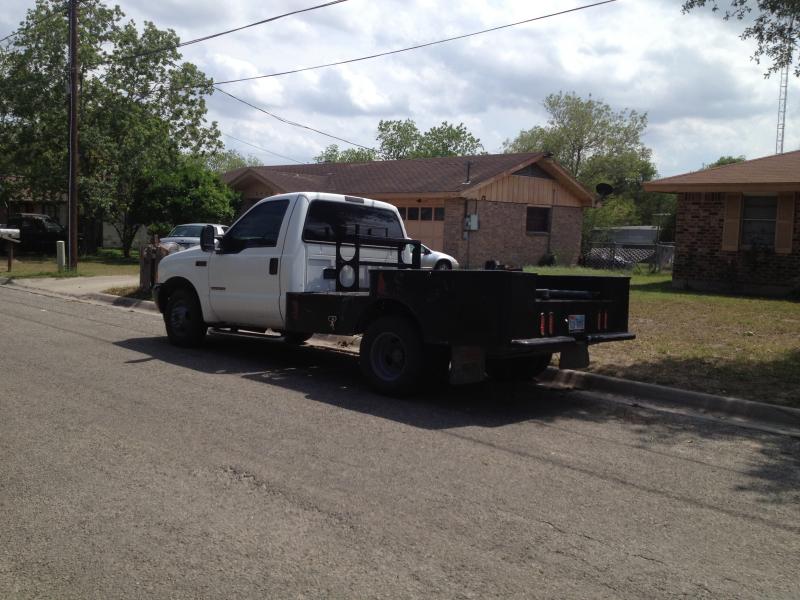

    Sand Man Shaggy's Avatar
    Dec 2007
    San Antonio or Victoria
    2,337
    Pics

    Registered User robertf03's Avatar
    6,850
    Nice truck!
