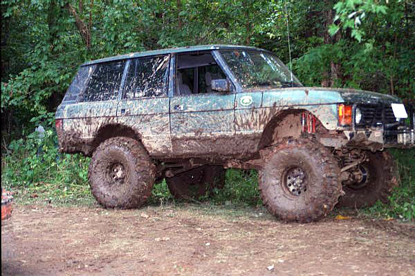

should I get some 37's for the rover?

whats up with the dual brake lines on that last pic?

damn....i didnt think rovers could actually look that good...
those look damn good man...i think you should go 37's

Don't Range Rovers have 4 piston calipers up front? Maybe that's just the required lines for each side of the caliper?Originally posted by robertf03

the front calipers are on two circuits. so if you loose one line you still have brakes in the front. RR's have 4 piston caliper fronts, two piston caliper rears, e-brake is a drum on the rear drive shaft.
