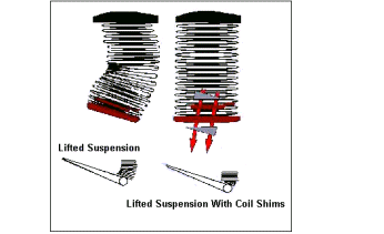

    one it makes it look better, and it is gonna give you a little extra clearance you might get 6in or actual lift versus 5 and a half or sometihing like that, also if you go to that sierrabronco site it shows u how the bent coils flex, it shows that when the suspension compress and decompresses that the bow will move forward and back not just to the side, because of the extra force put on the spring from the radius arm brackets, like somene posted earlier drop downs do help this problem, also of course the taller the spring the worse off it is and after a certain period of time the spring will retain this bowed shape, and i my opinion sag more, thats just my two cents on it when i do my 6 or 9 inch on my 78 i am going to either make something or buy those pre made ones i think they would be worth it i the long run,

    here is the pic of the sierra web page
