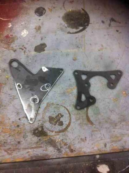

    The new steering worked much better, but not much thought went in to the brackets other than where the holes need to be
    This should will weigh half as much and looks a little more refined

    who are you having waterjet/laser your parts and bend them?
    Steven W
    02 Dodge 2500
    82 CJ-7 - sitting in a field...
    "....Your theory is f*cked up like a football bat...."
  8. #698
    Registered User robertf03's Avatar
    6,850
    its plasma cut at a school, I'll let him chime in if he wants it known that he's got a plasma table, if you can't piece it together with context clues in the thread.
    Going to bend it on a friends press brake.
    Had a machine shop in fort worth do the pulley hub.
    You ever use thomas net to send out RFQs?

    The cut quality is not a 100%, but that is due to a bolt together table being a pos

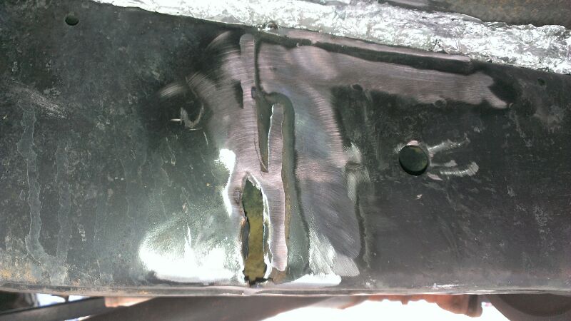

    so this was first noticed around TCC last year, with lots of help from BMF it was hammered back in place and welded up and made it through a few more outings before buckling, made it through a few runs after that too with lots of rubbing
    Cut it off and found it had ripped the weld from the frame.
    cut out a patch, snaked it in there with a stud welded to it and blasted it in place, replaced mount with YRM heavy duty mount
    Now it drives very different. That preload in the steering hid the alignment problems. Now I can get some readings of a machine and get the swivel balls drilled to correct caster.
