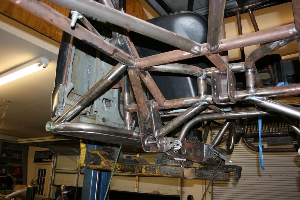

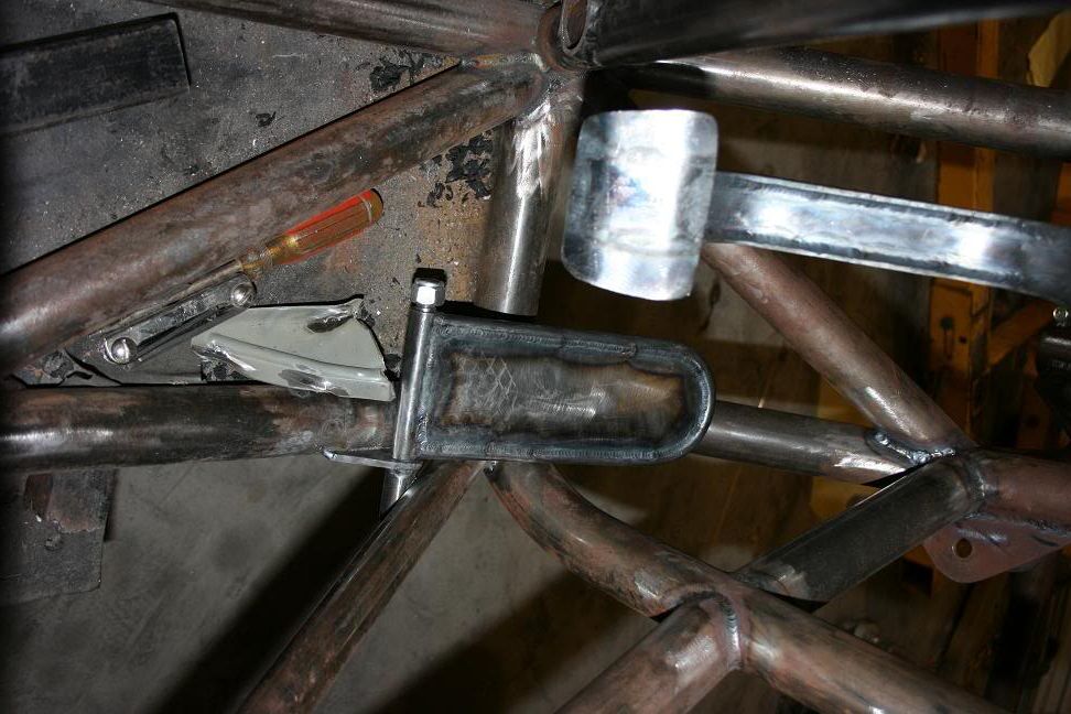

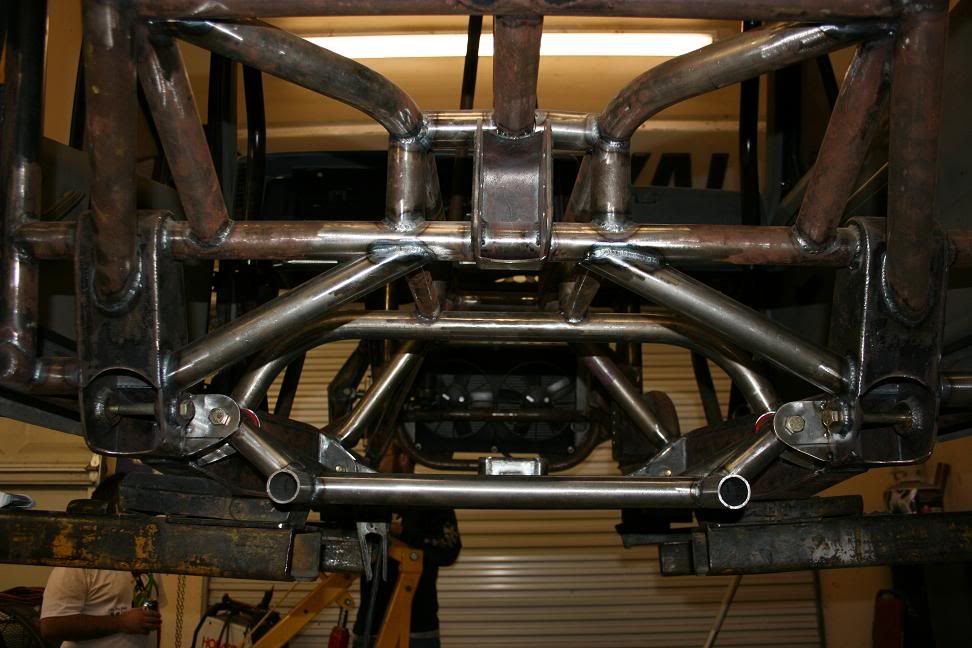

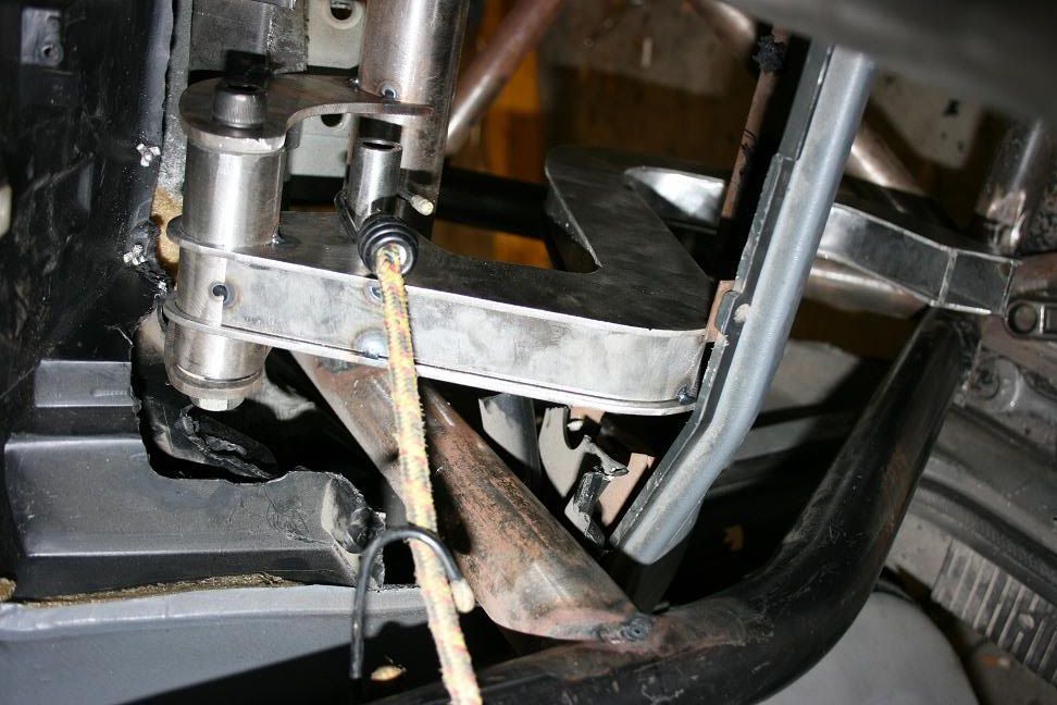

It has as much as any other 3 link, I am still not overly concerned because it only gets bad on the last few inches of articulation. I wanted 16" shocks for the verticle travel and rear steer came with it, I can deal with that. leaf springs create tons of rear steer I really don't hear people complainin bout them as it's a secondary criteria. I also think my framerail/torquebox rear link attachment setup is way stronger than any setup that mounts both lower links together in the center. with the way the motor is in there the lower links would have to go under the transfercase or be shortened more(only 34" now) to be triagulated anymore so not really worth it. the motor has to come out bottom and the 205 being wide limited rear link placement.
