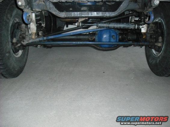

What the **** are you talking about here "I plan on drilling a hole in the tr and sleeving the hole with some toob and then putting a bolt through it." Are you talking about a redneck inverted y steering setup. Just run the "1 ton" (really 1/2 and 3/4 ton chevy stuff) tie rod ends that are all ready setup for an inverted y steering.
like the stock bronco setup
https://www.supermotors.net/getfile/...llsize/088.jpg
This is why i'm asking questions. with high steer can I use the steering that comes on the axle and just move it up?
You can run a t steering setup and have the drag link and tie rod go to the steering arm on the pass. side but you have to get the arm with two holes for this. Or you could run the inverted y steering and just have the drag link go to the tie rod. Like this. . . http://tamor.org/forums/showpost.php...&postcount=564
Just get a kit for this. . . where i got mine. . . http://completeoffroad.com/i-124127-...44-and-60.html
Edit: if the taper of the stock steering tie rod ends matches the taper on the new high steer arm and pitman arm the yes, just move up the stock stuff. You might have to shorten the tie rod a bit because the new high steer arm are more than likely angled in more severely than the stock lower arms.
bad I idea with whatever you want to do hear.
if you need to mount something to the Tie rod use one of these
That looks like it would slide when i'm in a bind
Once it is adjusted correctly, you can always tack/weld it in place.
Do what you can to find the correct highsteer/crossover arms and not have to worry about your tierod like that.
Also by having true crossover with the drag link going to the highsteer arm you are increasing the leverage by extending the fulcrum point, thus making your steering effort less.
