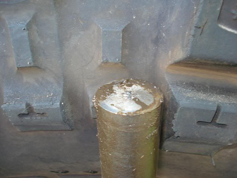

Ok, need some advice on getting the rest of the axle shaft out of the D70. Is the Detroit hollow through the middle and will they be able to just push the shaft piece out with a piece of rebar or the like? Or is this a futile task and the diff have to be opened up? I am going to try to get my little bro and Gpa to do it and may have to help walk them through it over the phone.

Don't think it will be hollow. I think your best bet will be some type of magnet concoction, I seen it done before.
Remember that detroit that the lady broke the shaft off in at Trees.
Had the rear shocks been on, the bed not floppin like an epileptic, the front axle been turned up like it needed to be, and the front traction bar been on, I am pretty sure it would have held up and possibly made it. I have a feeling the front drive shaft went and then the added stress and torque that got sent to the rear was too much for the axle in the spot it was in. :D

the detroit seemed alright because it drove in 1 wheel drive all of the way home?
But I have never really seen one break before so I don't know what they do
Booo!!! Take your negativity somewhere else. :flipoff2:
This has been brought up as we were wondering which had given out while we were trying to get turned around at that spot so I could get out. I guess I may just wait till I get home to mess with it.

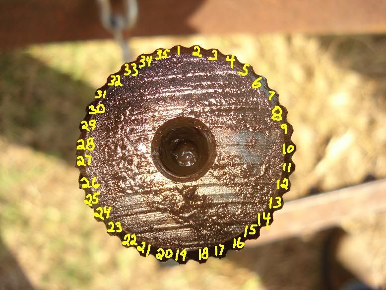

here is the tread on pirate about the CTM "drive home shafts"
They are 35 or 37 spline 300m shafts w/ 40 spline drive flanges. :gigem:

When you cant physically count the splines, just have someone snap a high-def pic and use paint to count them out. :gigem:
http://i47.photobucket.com/albums/f1...hevy/axle1.jpg
http://i47.photobucket.com/albums/f1...hevy/axle3.jpg
http://i47.photobucket.com/albums/f1...hevy/axle2.jpg
