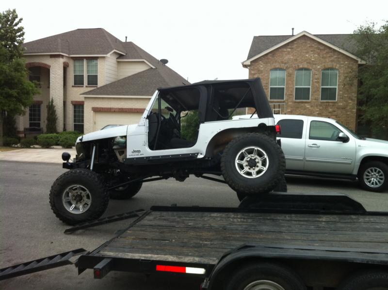

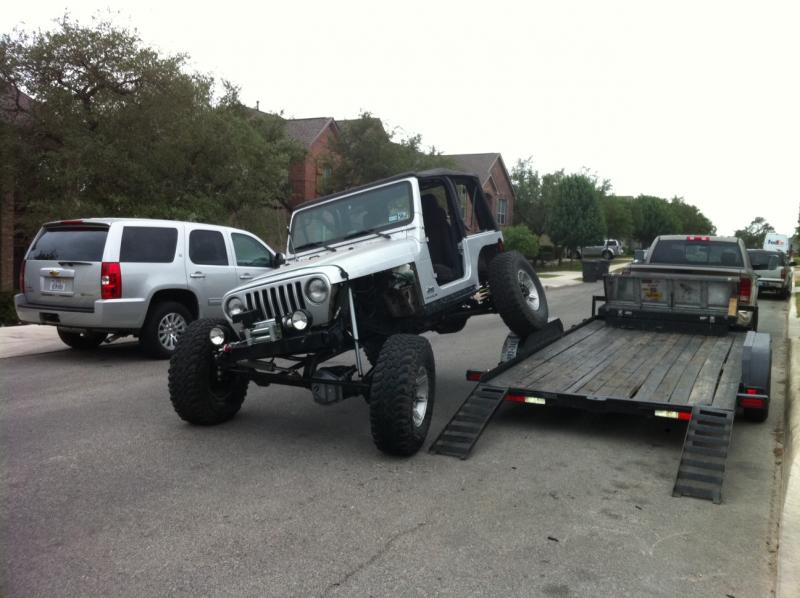

I would have paid the extra money if there wasn't still a laundry list if thinks to do on it. I did however get the front done today and now have it in full roller. I can't upload a pic from my phon but have it on facebook if anyone is curious. It came out at the exact ride height I was shooting for too.
Makes me wanna wheel so bad
pic
looks great, need to get mine back together too bad it won't look as nice
Thats pretty damn slick man. What is the final wheelbase?
After I adjust the links it will be somewhere between 112"-114"
Looks great!
looks awesome!!

Couple poser shots
Attachment 18555Attachment 18556
Looks good Tate. You're going to have to upgrade tires already! :D
looks good, when is the maiden voyage?
Freakin awesome
Is it just me or is the slider on the drivers side to far forward. And what are you going to do about front fenders?
