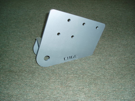

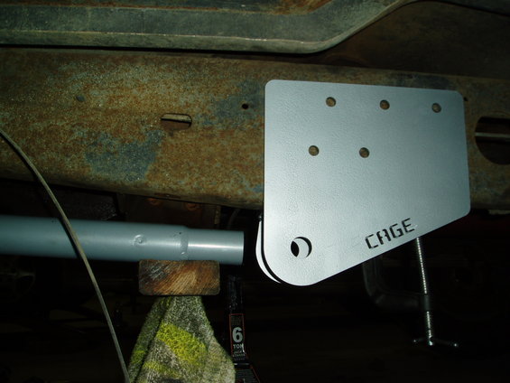

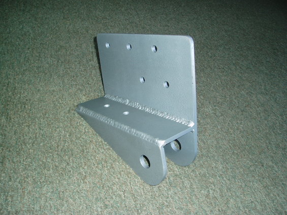

After some more digging I found Cage's improved RA mounts which did not require a backing plate, These appear to have came out in mid 2007 which is right around the time they went bankrupt, hopefully that wasn't caused by faulty RA mounts. I haven't found much feed back but I think Tommy will be fine with what he has and we can keep moving on for now.
http://www.supermotors.net/getfile/4...ra-bracket.jpg
http://www.supermotors.net/getfile/4...ket-inside.jpg
http://www.supermotors.net/getfile/4...et-outside.jpg
Now to prevent confusion, I think a backing plate is a much better idea than boxing the frame or a new cross member but we really just need to get this thing out and rolling again. Then if we feel it is necessary we'll add one.

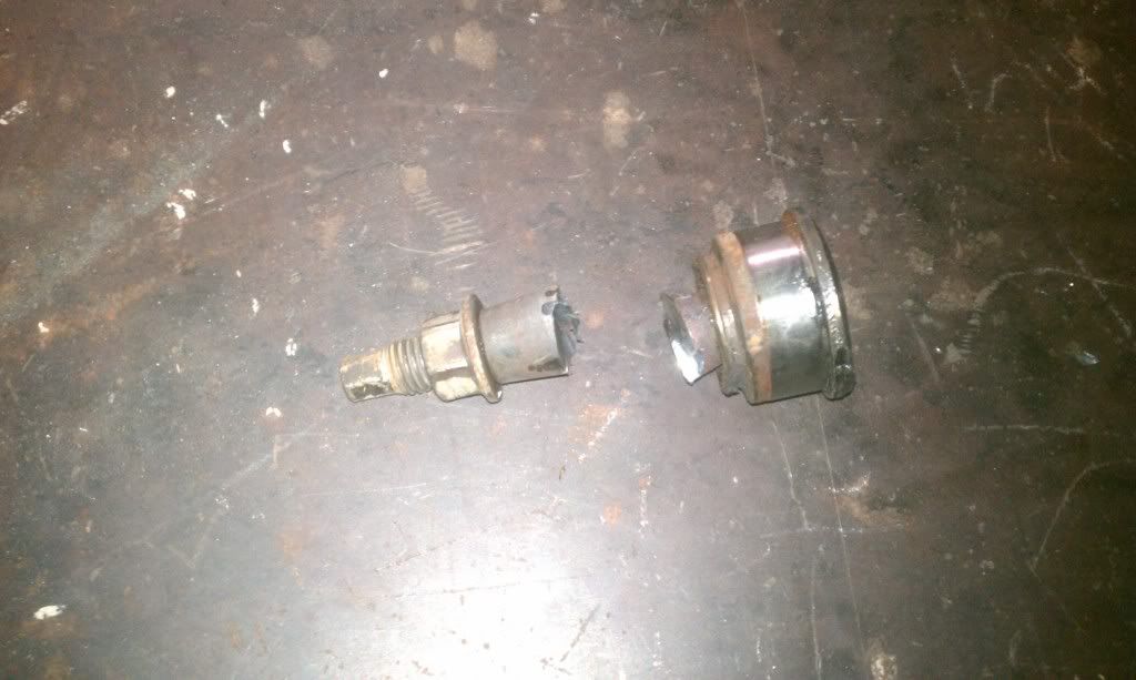

got the factory track bar mount (janky ass ball joint thingy) out. I had to grind the bottom of the ball joint off to get the press on there. Pain in the ass but it's done now.

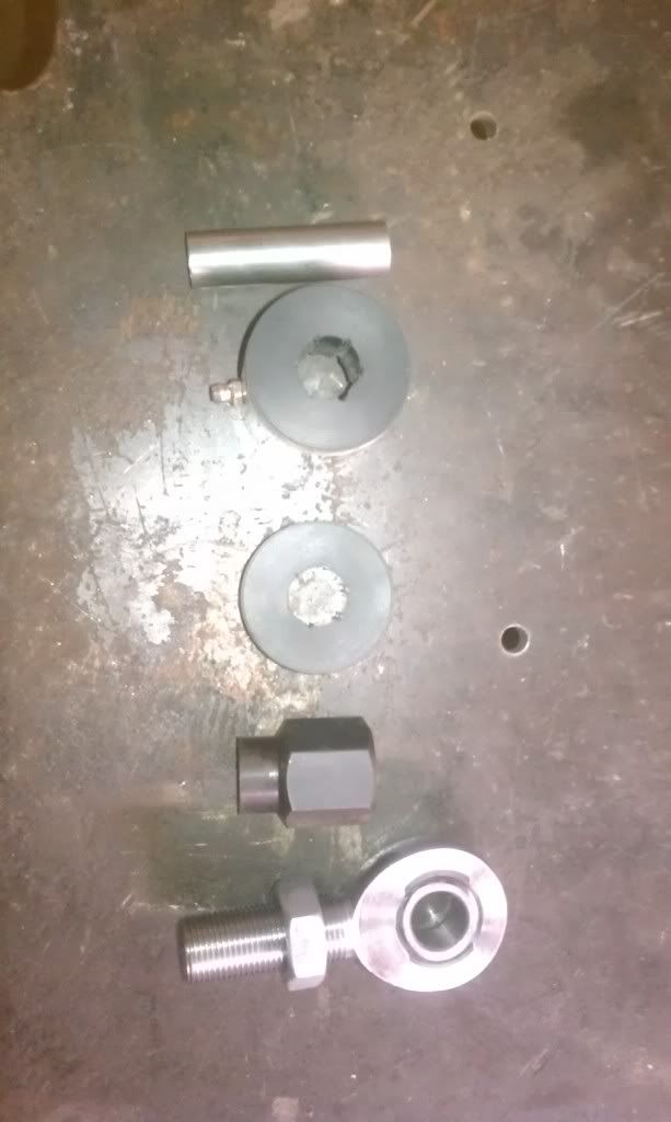

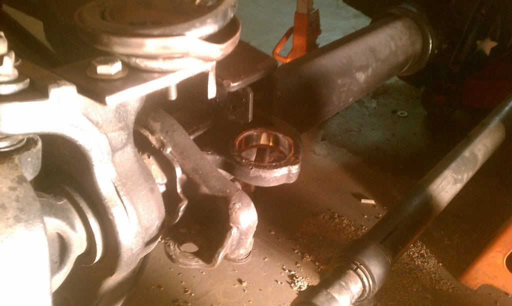

Dom bushing will go where the big new hole is. We're going to make a hockey puck out of some 3/8" plate, then put another piece of plate on top of that, then put some tabs on it for the bushing. The top side is a 3/4" heim that will go into the factory track bar mount or vica verca, whichever works better.
