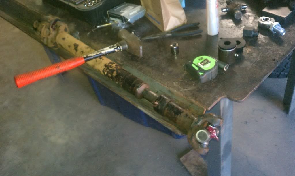

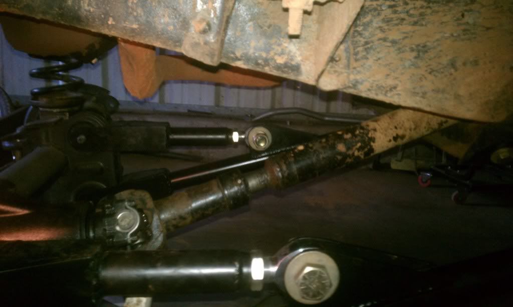

Got my 1330-1350 conversion u-joint in. I will use the conversion u joint till I do my 205/1356 doubler, then i'll get 1350 yokes on the transfer case and have new driveshafts made.
http://i736.photobucket.com/albums/x...V/IMAG0075.jpg
http://i736.photobucket.com/albums/x...IMAG0076-1.jpg
Did you re-use the front driveshaft? Did you move the axle forward an inch, it is my experience that a dana 60 pinion is 1 to 1.5" longer than a dana 44, this means the driveshaft needs shortening. Thoughts?
If possible drill where the straps go out, to where you can put u-bolts. This is stronger. If you do not do this, the bronco will light on fire and everyone inside of it will die of the hiv.
Yeah I think the driveshaft needs to be shortened a bit. I agree I like the u bolts better. I'll probably end up doing that.
