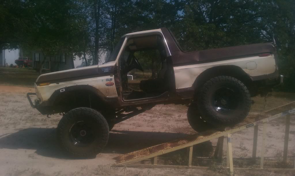

Drove all around town today. Brakes are awesome, front cardan joint needs to be rebuilt. Handles awesome, no dw, tracks straight and no vibrations. I got lots of looks.
http://i736.photobucket.com/albums/x...V/IMAG0141.jpg

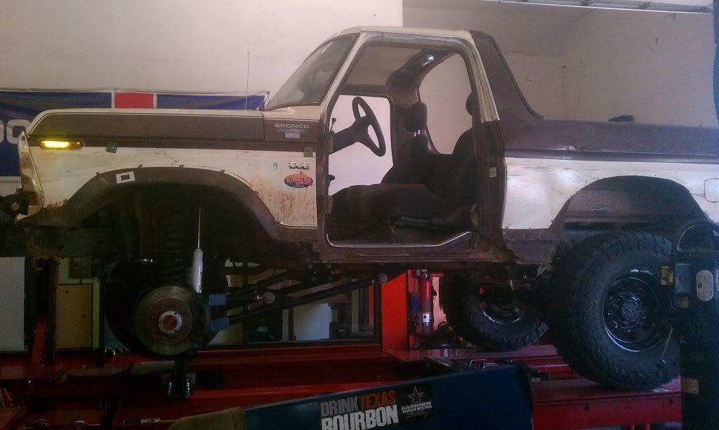

Getting the front tires put on. Also looking over everything on the lift. Good thing I did, some bolts needed to be tightened.
http://i736.photobucket.com/albums/x...V/IMAG0144.jpg
http://i736.photobucket.com/albums/x...V/IMAG0143.jpg
http://i736.photobucket.com/albums/x...V/IMAG0148.jpg

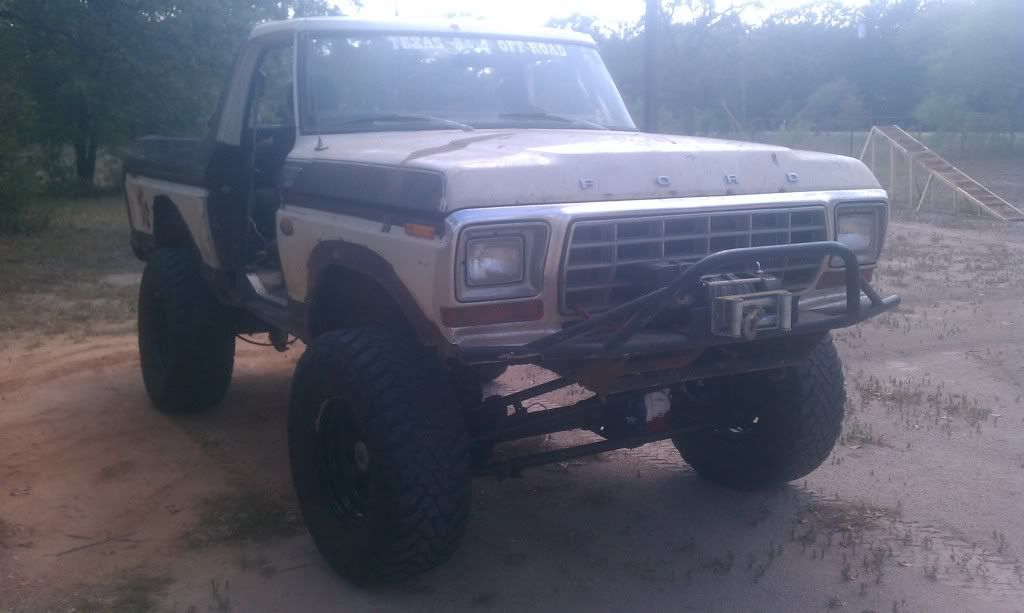

Looks better with the 37's
Flex sucks with the shocks
Do you think those other red shocks would work better?
Yeah I should try those

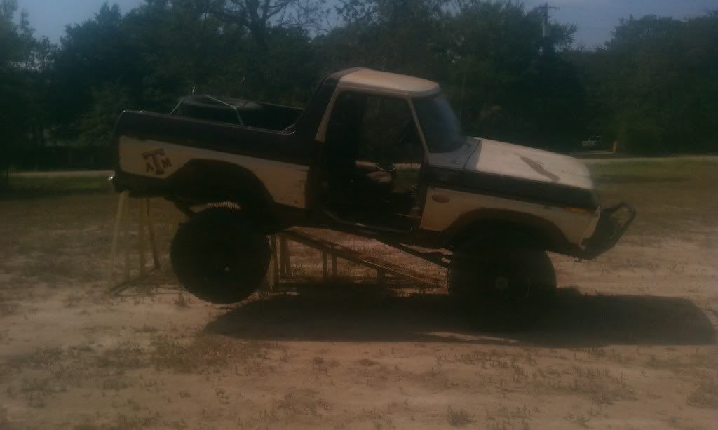

http://i736.photobucket.com/albums/x...V/IMAG0152.jpg
Put the 3g on.
Charge cable is 2 guage wire to a 200 amp breaker to another 2 guage wire to the starter solenoid. Before I was at 12.5 volts at idle, now i'm at 14.5 volts at idle. No more flickering of headlights and I actually saw a performance gain.
It runs alot smoother at idle for some reason, sounds like it did with the carb.
