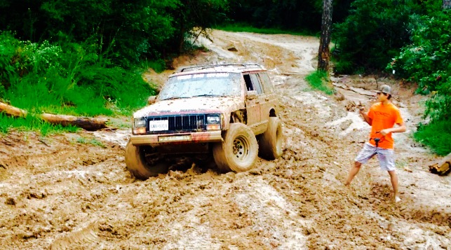

    Haven't been on in awhile but here's another update. Wheeled a lot since I Iraq started this thread, also done my homework on building it up. But for now 2" BB and 33s with trimming and bumpstops is what I'm running now on it. LOVE the bigger footprint. Plans for axles is to swap in a HP Dana 30 front and Chrysler 8.25 rear go with 4.56s and Aussie locker. Lookin into a hybrid 4in from DPG Offroad it's a rubicon express left with some off there goodies thrown in for just under 1k. Hoping to make it to Clayton ready or not this year and wheel the hell outta it. Threw in a sound system, rock lights a light bar for night wheeling we've done at hidden falls. Eventually want a 3 link set up instead of a radius arm set up whenever I go long arms. Here's a pic of it two weeks ago in Huntsville at General Sam's. I'm still getting the mud out of my ears!

    Looks fun
