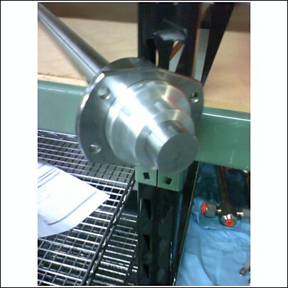

now for what brand of gears. I have always heard good things about richmond gears and I saw that mark williams sells them with a 35 spline pinion. That should be alot stronger than the stock 28 spline pinion.
not sure what to do about the center section. nodular iron is what I was thinking.
Oh and where to get good 35 spline shafts
